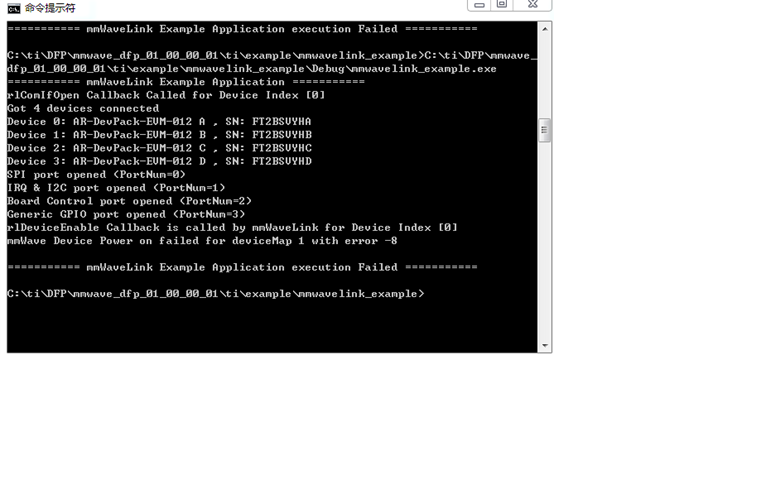

Compiler/AWR1243BOOST: mmwavelink_example on the DCA1000EVM + AWR1243BOOST combination?
Part Number: AWR1243BOOST
Other Parts Discussed in Thread: DCA1000EVM,
Hi, I have connected the DCA1000EVM with the xWR1xxx EVM,all COM ports are installed,  the device manager recognizes these devices and indicates the COM port numbers.How can this example (mmwavelink_example.exe) be run with the DCA1000EVM + AWR1243BOOST combination?
It always gives the error: "mmWave Device Power of failed with error -8"
How should I do  mmwavelink to enable, configure and control Master SS and Radar SS on the  DCA1000EVM + AWR1243BOOST combination?
Thank you in advance!
  • Hi Steven,
    Please check that when you run this application, it downloads firmware files [MMWL_firmwareDownload] over SPI (erase the sFlash before it).
    Make sure you have connected USB cables to AWR1243BOOST EVM and DCA1000EVM (RADAR_FTDI USB connector).
    Jitendra
