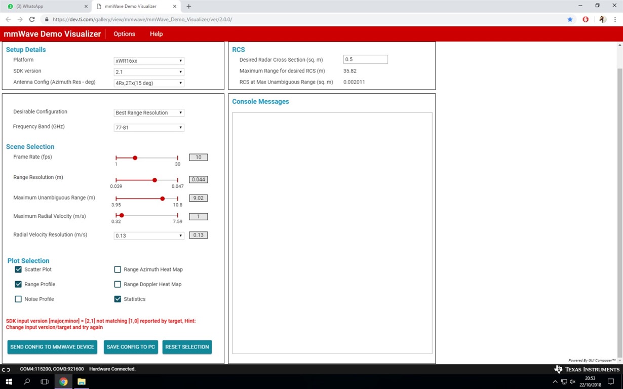

I have an AWR1642 boost and its version of SDK 1.0 doesnt work since october 5. I actualized the version to the lastest, version 2.1 for the SDK, and it doesnt work. The visualizer demo doesnt let me to choose the version 1.0 anymore.
I dont know how to actualize the AWR1642 to let it read the new VERSION 2.1. I have talked through the chat and the technical service doesnt help me because they dont know, I guess. I just need to read the AWR1642 through the visualizer demo.
Also, we have reset the device and it doesnt work neaither. I attach the screenshot of the demo's message:
At least, The device has been actualized twice with the lastest versions after the reset.
