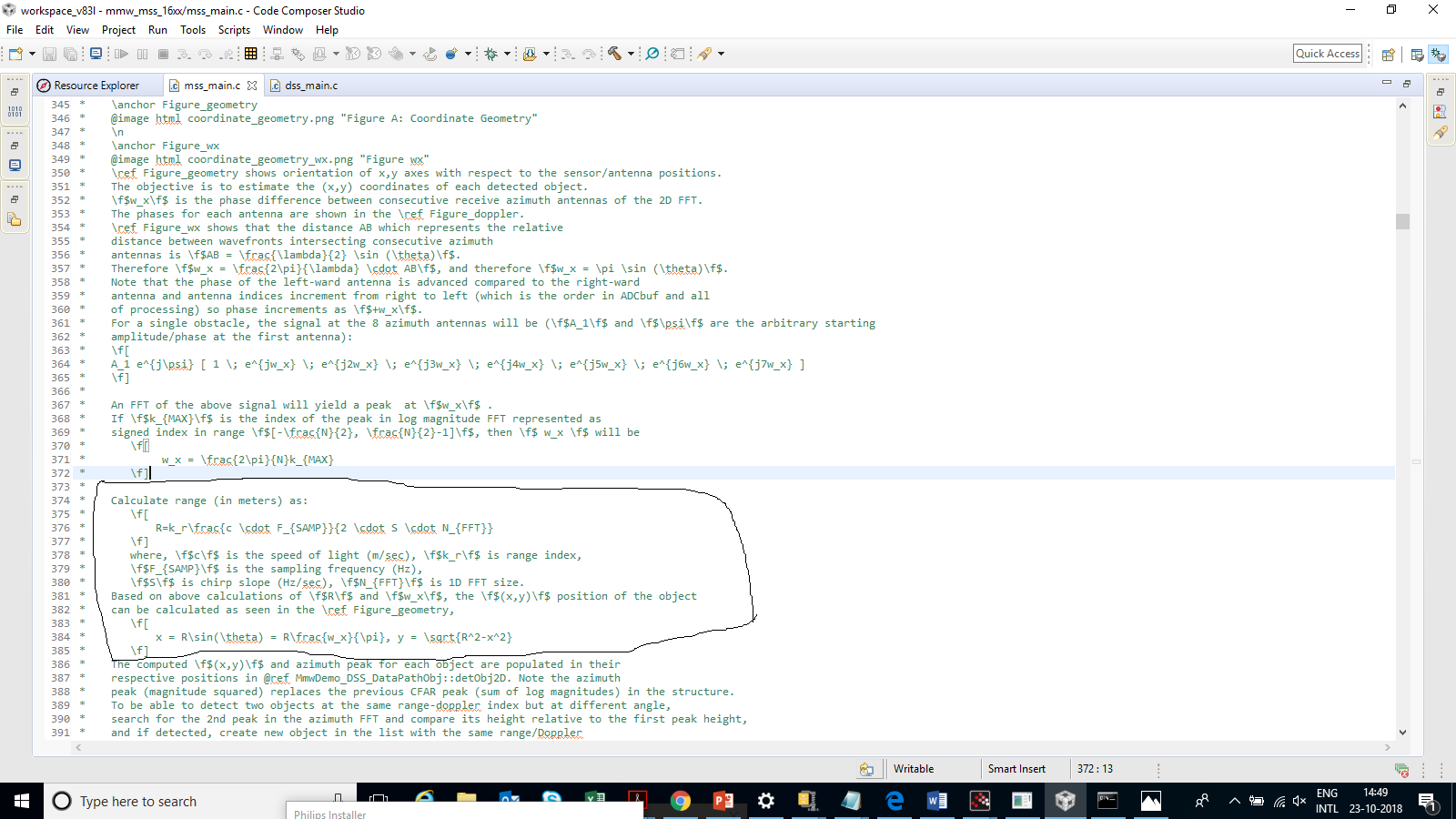

I want know,where exctly the range value is calculated prior to display on visualizer?
What is the resoluton of range, like( it measure only 100cm, 90cm in steps of 10 cm or in steps of cm is it possible after reaching near the object by 10 cm, 9cm,8cm?
I have already checked with High accuracy lab but since FOV is coming very less. I want to try this with mmwave demo, If I could get range value found by the radar and I can compare that, so that the FOV is around 60 degree.
Kindly ans these
1. Where exactly the range value is calculated(like we have tempRange in high accuracy lab)?( it would be good if you show in code)
2. Till what point It can give range accurately?(for me it should be below 10cm ..and in steps of atlest 9cm,8cm,7cm etc...
3. As shown in above image it is said that we can calculate the range in meteers using the formula, is it there already in code?if not how do we write it and where?
regards
Karthik
  • Hi Karthik,
    The mmWave SDK demo accuracy is on the order of 1cm.
    As mentioned previously regarding the mmWave SDK demo: "You can search the ARM file "C:\ti\mmwave_sdk_02_00_00_04\packages\ti\demo\xwr16xx\mmw\mss\mss_main.c" for "MMWDEMO_DSS2MSS_DETOBJ_READY" to find the place that the ARM receives the data and sends it over UART. The data format/structure is also described in the mmWave SDK demo documentation. (C:/ti/mmwave_sdk_02_00_00_04/packages/ti/demo/xwr16xx/mmw/docs/doxygen/html/index.html)"
    Specifically, a description of the detected object data (with X, Y, Z data in meters in Q-format) in the mmWave SDK demo was given in the following post.
    e2e.ti.com/.../2707925
    As previously mentioned, modifying embedded C code for a specific desired behavior requires a good working knowledge of C programming and requires the user to analyze the code to understand how it is working and thus how it should be modified to achieve the desired behavior. The mmWave E2E forum provides support to point users to existing documentation and examples and give pointers on how to go about supported modifications, but is not intended to supply complete/tested custom code modifications for individual use-cases that are not supported by the existing demos.
    John
