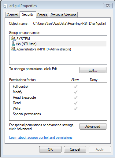

The 'C:\Users\tsn' folder is read-only by the way. Is that the problem? I have tried to change the properties of the folder, but it doesn't seem possible (it goes back to read-only after I make the changes). I can connect to the devices though, and run 'DataCaptureDemo_xWR.lua', but once the program is done, I get an error message that the adc_data file is empty. So I figured maybe the above-mentioned error message is the underlying cause (can't seem to connect to the FPGA either, getting version 0.0.0. Downloaded the FPGA bit-file again, but no change in the problem).

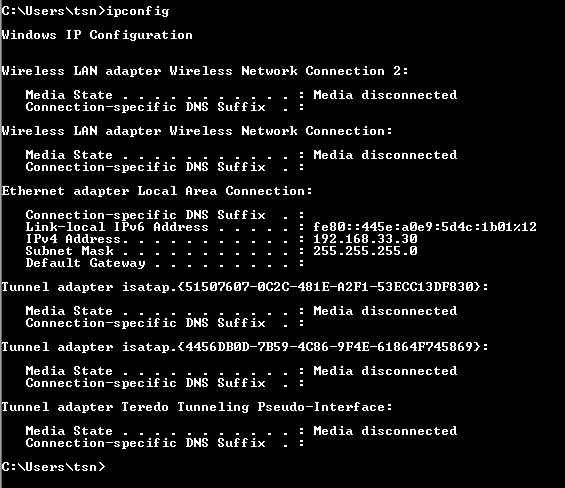

    Make sure you have the Ethernet cable connected to your PC and then you set your PC with the IP address as specific in the DCA1000 User's Guide. You can find the User's Guide and Quick Start Guide below:

    Please make sure that the user's folder is not read-only.

    I have followed the instructions in the User Guide. As for the read-only thing, I checked the propterties of the C:\Users\tsn\AppData\Roaming\RSTD\ar1gui.ini file and get the following (so I assume that's not an issue):
    I have configured the IP address according to the guide:
