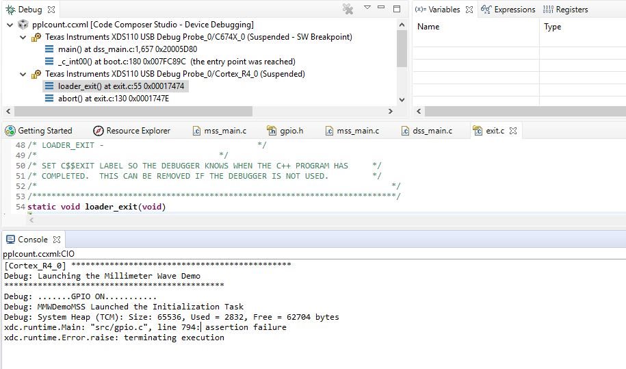

Hello TI,
in my application i need to set GPIO when motion is detected
but i try to Config GPIO, It's not accept GPIO Configuration shows the asserts problem
for GPIO configuration i take reference from  CCS Cloud lab0005-high-accuracy-16xx and try to make changes ti provided  lab0005-high-accuracy-16xx project
please try give step for how configure GPIO and documentation
i attach image file for reference
Thanks TI
  • Hi Rahul,
    All of the mmWave SDK driver documentation (including GPIO) is found in the mmWave SDK docs directory in C:\ti\mmwave_sdk_<ver>\docs\mmwave_sdk_module_documentation.html.
    You can also look at the following post as an example.
    e2e.ti.com/.../2706379
    John
    I configure GPIO Successfully in High accuracy  demo code but same procedure use to Configur GPIO in PPLCount Demo code it's shows assertion failure  problem
    provide some GPIO configuration step or some Documents for PPLCount Demo code
    there is some changes related to GPIO Config and use in Hgh accuracy code in between CCS imported and CCS Cloud MSS Source code...?
    Can you  provide CCS Cloud Source code it's help me lot further development

  • Rahul,
    CCS Cloud version is not currently supported for TI mmWave devices and will likely cause problems.  Please follow the instruction in the setup guide in the mmWave SDK Demo - 16xx lab on the TI Resource Explorer to create a working CCS project for the mmWave SDK demo from the Industrial Toolbox.
