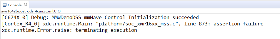

I am attempting to implement CAN transmit on the AWR1642BOOST-ODS ES2.0.
I have added and removed resistors are instructed in the user guide(mounted 0 ohms on R11 and R12 and removed R4, R6, R28 and R63).
I downloaded mmwave_automotive_toolbox_2_4_2 and followed the ObjectDataOverCAN_GettingStartedGuide in lab0005_object_data_over_can.
But it doesn't work.
I used an oscilloscope to measure the waveforms at both ends of CANH and CANL on the J3 interface. No change in voltage difference is generated.
I have been troubled for a long time, I have not found the problem.
