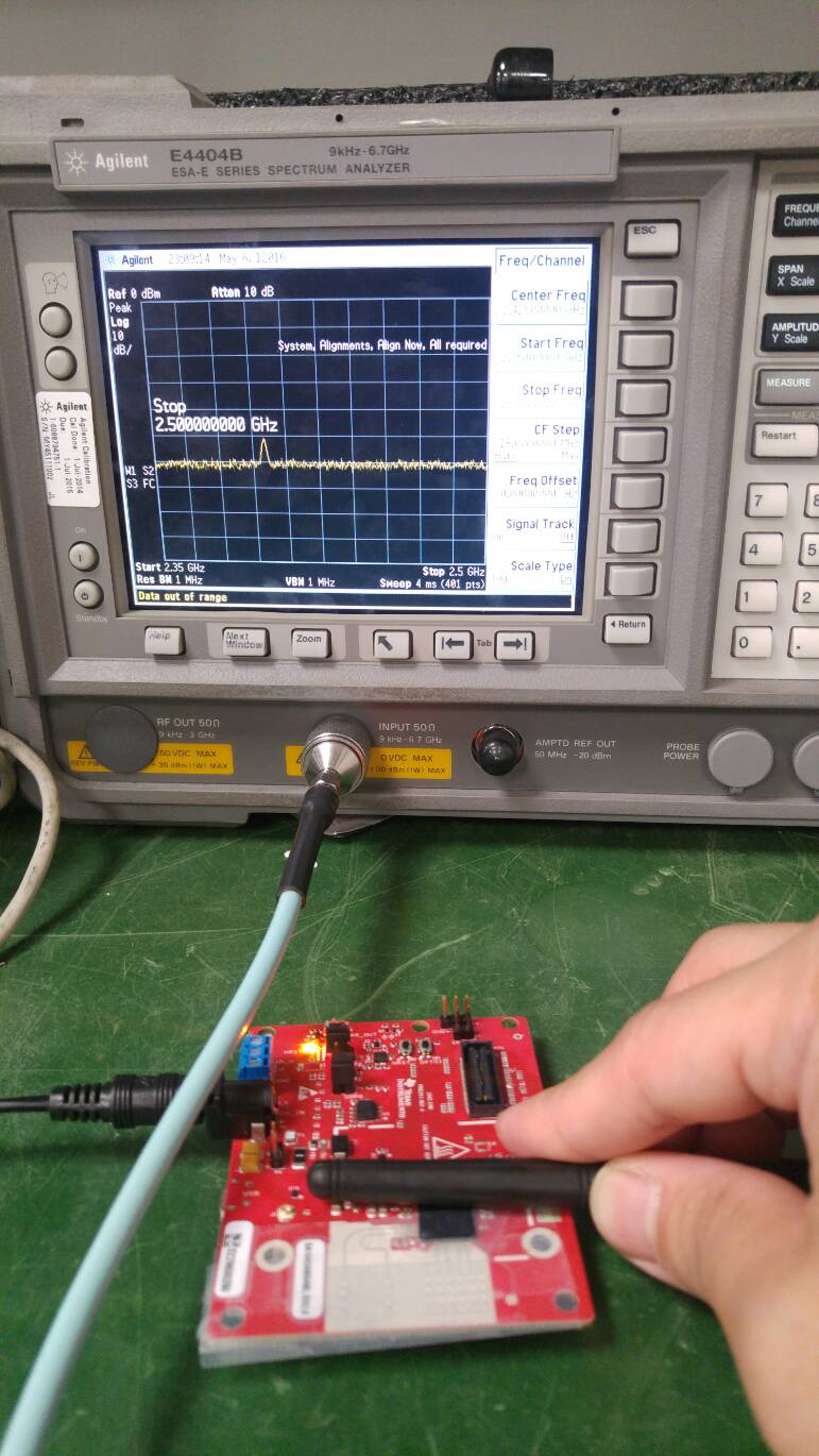

Why is 2.4G generated on the AWR1642 Chip(ES2.0) ?
You could refer to attach mail for Radiation test fail if we use worse Cable which don’t have GND shield.RE AWR1642 Radiation test.msg
Hi Vivek
Vehicle vendor is hard to use the cable of GND shielding, and they think it is TI chip design issue.
Could TI have improvement plan? We can't think Vehicle vendor must use the cable of GND shielding.
Hello Charles,
Unfortunately we are unable to make any change at this point related to this issue.
Vivek
