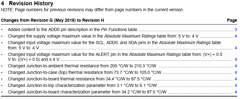

Can you please let me know the background of this changes?
The changes look performance degradation for the customer like the absolute max range being narrow.
Also, with regards to the changes in thermal information, I know that sometimes these parameters are updated based on more accurate thermal models.
Is this the case?
