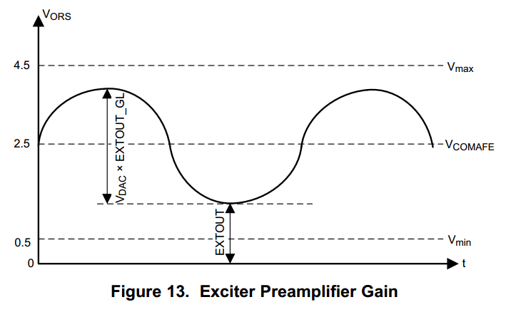

I have some questions about the exciter signal generator of PGA411-Q1:
1. What's the typical value of Vdac in figure 13?
2. From figure 13, EXTOUT+1/2 EXTOUT_GT*Vdac=2.5, that's to say,  if one of them is set, another is fixed. Why we set both of them?
3. What's the typical drive current for a resolver sensor? Typically, the parameter is not specified in the resolved datasheet. Does this parameter help us select EXTOUT_GL? Or in other words, how to select EXTOUT_GL?
Thanks.
