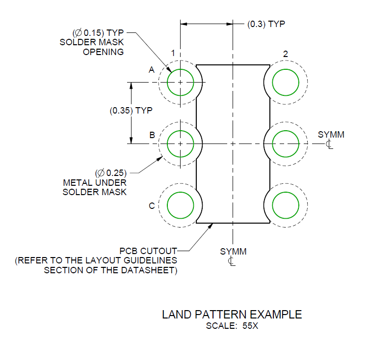

Hello
Can you tell me the definition of "METAL UNDER SOLDER MASK and SOLDER MASK OPENING in the LAND PATTERN EXAMPLE specification of OPT3007 as shown below?
I would like to know if this part is LAND.
Or, if you have any related resources, please let me know.
Thank you

  • Hi Anthony,
    Metal under solder mask means that the metal pad extends under the soldermask. The solder mask opening is the size of the soldermask opening - this is the exposed pad.
    I do not follow what you mean by "I would like to know if this part is LAND".
    Does this answer your question or did you have further questions here?

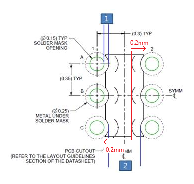

  • Hello
    The distance between Solder mask opening and Metal undersolder mask is 0.05mm, but my customer's PCB manufacturing specification requires at least 0.2mm of spacing.
    If the customer wants 0.2mm, Cut area should be as narrow as that, and I think that Sensing Area is going to be a problem.
    But my customers want to hear from TI
    Please advise me.

  • Hi Anthony,
    What is the reason for choosing OPT3006/7 over OPT3001? OPT3006/7 achieves much smaller size but requires better tolerances than OPT3001 so it is advised to use only if space is constrained or there is another good reason to choose it. Also since you chose OPT3007 there are two pins that are NC. This allows you to do a larger cutout if you do not solder those pads over OPT3006.
    Please check the OPT3006 page for the FoV simulator tool. This will let you put in the cutout size parameters and simulate performance.
