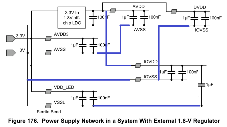

Is my understanding correct that the uC should be connected to OPT3101 as below ?
Kato

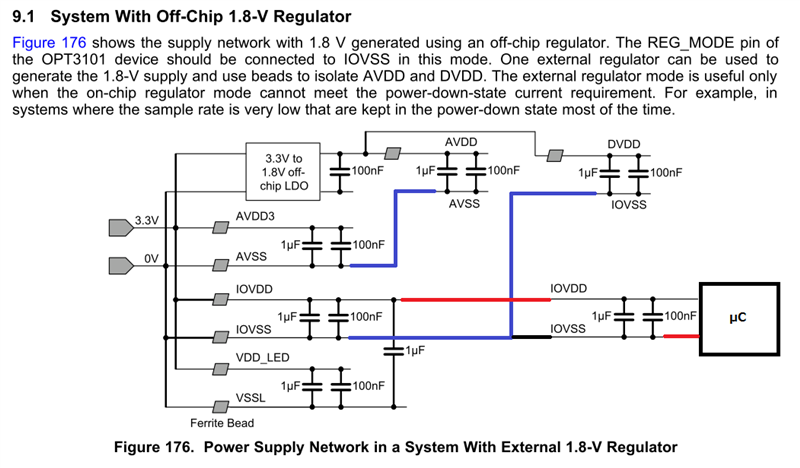

Kato
