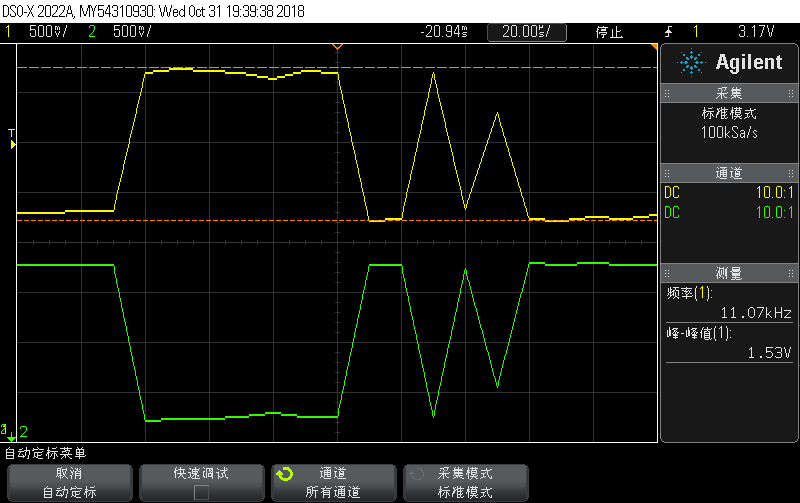

Now when running the CANFD demo, the oscilloscope can measure the differential voltage waveform between CANH and CANL.As shown below:
Q1: Although there is an output waveform, once the host computer initializes PCAN-USB, the waveform disappears.

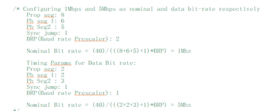

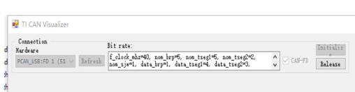

Q2: How do I calculate the parameters in the Bit rate Input box in the TI CAN Visualizer GUI? How to correspond to the parameters in the SDK code below?
    /* Configuring 1Mbps and 5Mbps as nominal and data bit-rate respectively
        Prop seg: 8
        Ph seg 1: 6
        Ph Seg2 : 5
        Sync jump: 1
        BRP(Baud rate Prescaler): 2
        Nominal Bit rate = (40)/(((8+6+5)+1)*BRP) = 1Mhz
        Timing Params for Data Bit rate:
        Prop seg: 2
        Ph seg 1: 2
        Ph Seg2 : 3
        Sync jump: 1
        BRP(Baud rate Prescaler): 1
        Nominal Bit rate = (40)/(((2+2+3)+1)*BRP) = 5Mhz

    The TI CAN Visializer application is only for the Object data over CAN (TI REX project). The bittiming values in this application are "Bit Rate " window.

  • Hi Raghu,
    1. I just use Object data over CAN (TI REX project), and the corresponding TI CAN Visializer application.But once the TI CAN Visializer initializes, the waveform disappears.
    2. As shown below, I don't understand why the values written in these two places are different? How should I convert these two values?
