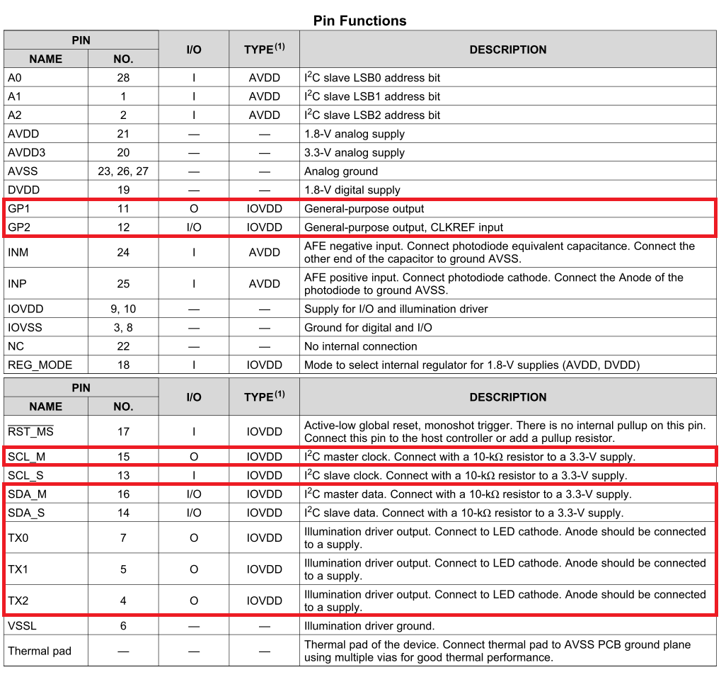

Could please tell me whether the outputs(GP1, GP2, SCL_M, SDA_M, SDA_S, TX0, TX1 and TX2) are placed to Hi-Z during the sleep mode and standby mode ?
Kato
Kato
