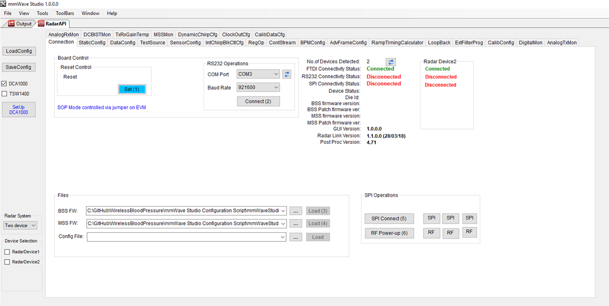

I have two IWR1443BOOST boards, each connected to a DCA1000EVM using the 60 Pin HD Adapter. On board is configured to use the default IP address and the other use configured to use a different IP address stored in EEPROM. When I boat up mmWaveStudios it detects both boards.
I check one of the boxes and then click on "Set", followed by "Connect" and finally I run my Lua Script. Normally, with only one board connected, my Lua Script runs fine and the firmware is loaded onto the board. However, when I try to run the same script with two boards it just gets stuck and never finishes running. Is it possible to connect two boards to one computer? Do I need to make some kind of modification to my LUA script?

    I only have one instance of mmWaveStudio running and if I try to start another it gives me an error saying "Application already running. Only one instance of this application is allowed"
    In the screenshot I posted you will see on the left hand side it recognizes that there are two board connected. I'm assuming that's because mmWaveStudio is set-up to work with multipule board. The problem is I'm only able get one running at a time.

  • Salah,
    mmWave studio does not support multiple setups for EVM's or DCA1000, this capability is reserved for AWR1243.
    Sorry for the confusion, but if you give a little more details on what you are trying to achieve we might be able to help.
