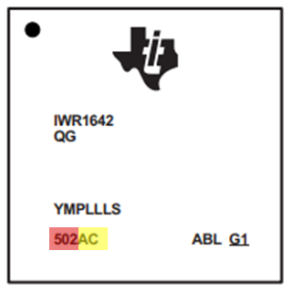

We have two mmWave sensor board (IWR1443BOOST and IWR1642BOOST) which have been purchased within the last 3 weeks from TI. When we go to the TI resource explorer and try to run the people counting lab we see the warning:
"This lab will only work if the IWR1642BOOST EVM has a sticker that says "ES2.0". ES2.0 devices will only work with software based on mmWave SDK version 2.0 or above. If the EVM does not have the sticker, the device is ES1.0 and requires mmWave SDK version 1.xx.xx.xx."
Since neither of the board have the ES2.0 sticker can we assume these boards are not able to work with the SDK 2.0 ?

    The ES version is the silicon revision of the mmWave chip on the EVM.
    The more recently purchased EVMs may not come with an ES2.0 sticker even though they have ES2.0 devices on them.  You can check the device marking on the chip using the information in the IWR1642 Errata doc to verify which ES version is on the EVM.  Please see the following device marking diagram copied from the Errata doc.
    • If the part identifier only reads "502" (highlighted in red), the device version is ES1.0
    • If the part identifier reads "502AC" (highlighted in red and yellow), the device version is ES2.0
    If you do have ES1.0 devices, you can find instructions on accessing earlier versions of the labs/demos that will work on IWR1642 ES1.0 at the bottom of the Industrial Toolbox labs page.
