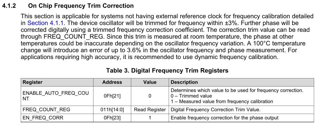

MSP430 would provide the external clock to OPT3101 GP2 port on OPT3101EVM, so is my understanding correct that the external clock frequency is 10-MHz ?

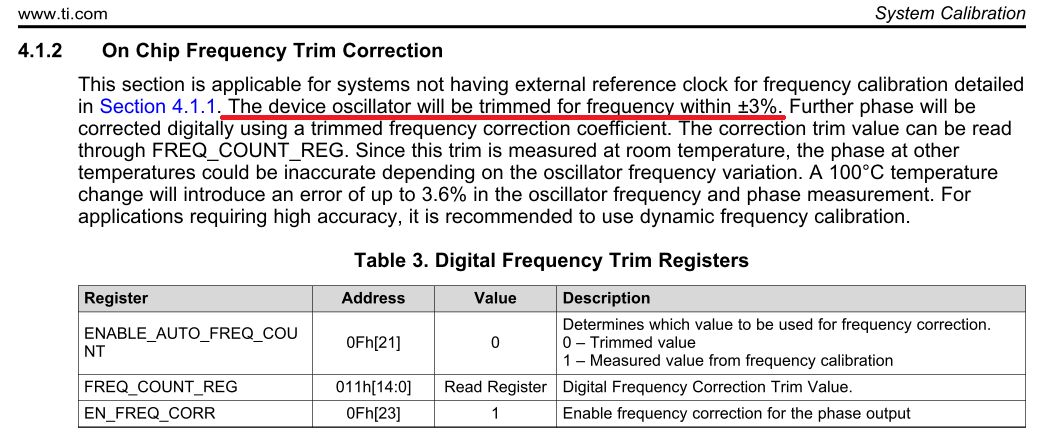

In addition, the internal clock frequency will be trimmed within +/- 3% as below, so please share the distance measurement data as described in the following application note when comparing the internal clock with the high precision external clock.
Application of OPT3101 in Precise Distance Measurementand Ranging Applications
http://www.ti.com/lit/an/sbaa296/sbaa296.pdf
