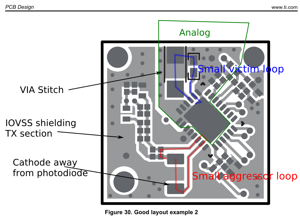

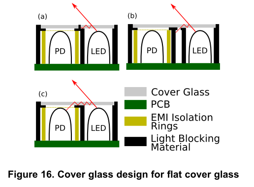

It seems that the EMI isolation rings cannot be mounted on the pcb if applying "Good layout example 2" as the pcb layout.
So, are the EMI isolation rings unnecessary if using a chip type LED and PD ?
