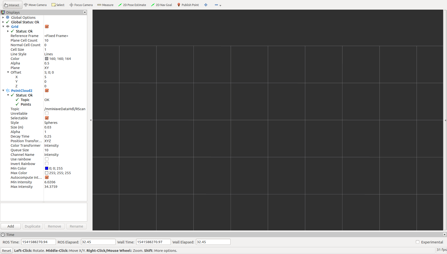

Hi Guys,
I am having trouble getting points to be displayed in Rviz.
AWR1642BOOST ES2.0 (502AC)
SDK 2.0
I have reflashed the device using UniFlash to get the  SDK OOB Demo working in the Google Chrome browser. The OOB demo works for both SDK 2.0 and SDK 2.1.
I can run the roslaunch command without getting any errors. All of my commands register as successful. My D3 light is on. I have tried power cycling of the device and power cycling of the system. I have also added the "lowPower 0 1' command to the .cfg file. I will include the CLI log of running the roslaunch command, a picture of the Rviz window, and the text of the .cfg file.
Thank you for your patience in working with me as I learn more about this device.
Respectfully,
Garrett
garrett@_:~/catkin_ws/src/ti_mmwave_rospkg$ roslaunch ti_mmwave_rospkg rviz_1642_2d.launch
... logging to /home/garrett/.ros/log/3e7181ec-e279-11e8-9ccc-d89ef3776fdc/roslaunch-oci-30421.log
Checking log directory for disk usage. This may take awhile.
Press Ctrl-C to interrupt
Done checking log file disk usage. Usage is <1GB.
started roslaunch server http://:39737/
SUMMARY
PARAMETERS
 * /mmWave_Manager/command_port: /dev/ttyACM0
 * /mmWave_Manager/command_rate: 115200
 * /mmWave_Manager/data_port: /dev/ttyACM1
 * /mmWave_Manager/data_rate: 921600
 * /mmWave_Manager/max_allowed_azimuth_angle_deg: 90
 * /mmWave_Manager/max_allowed_elevation_angle_deg: 90
 * /rosdistro: kinetic
 * /rosversion: 1.12.14
NODES
    mmWaveQuickConfig (ti_mmwave_rospkg/mmWaveQuickConfig)
    mmWave_Manager (ti_mmwave_rospkg/ti_mmwave_rospkg)
    rviz (rviz/rviz)
    static_tf_map_to_base_radar_link (tf/static_transform_publisher)
auto-starting new master
process[master]: started with pid [30431]
ROS_MASTER_URI=http://localhost:11311
setting /run_id to 3e7181ec-e279-11e8-9ccc-d89ef3776fdc
process[rosout-1]: started with pid [30444]
started core service [/rosout]
process[mmWave_Manager-2]: started with pid [30452]
process[mmWaveQuickConfig-3]: started with pid [30462]
[ INFO] [1541587102.572424664]: mmWaveQuickConfig: Configuring mmWave device using config file: /home/garrett/catkin_ws/src/ti_mmwave_rospkg/cfg/1642_2d.cfg
process[static_tf_map_to_base_radar_link-4]: started with pid [30463]
[ INFO] [1541587102.575848627]: waitForService: Service [/mmWaveCommSrv/mmWaveCLI] has not been advertised, waiting...
process[rviz-5]: started with pid [30474]
[ INFO] [1541587102.593251092]: Initializing nodelet with 12 worker threads.
[ INFO] [1541587102.595971154]: mmWaveCommSrv: command_port = /dev/ttyACM0
[ INFO] [1541587102.595994357]: mmWaveCommSrv: command_rate = 115200
[ INFO] [1541587102.598098709]: mmWaveDataHdl: data_port = /dev/ttyACM1
[ INFO] [1541587102.598112932]: mmWaveDataHdl: data_rate = 921600
[ INFO] [1541587102.598119482]: mmWaveDataHdl: max_allowed_elevation_angle_deg = 90
[ INFO] [1541587102.598125025]: mmWaveDataHdl: max_allowed_azimuth_angle_deg = 90

Rviz display. Notice there is no confirmation text next to "Points" check box.
  • Hi Garrett,
    Please check the ROS Point Cloud Visualizer lab release notes and/or the Industrial Toolbox labs page to see which EVM and mmWave SDK are supported by each lab.  The current lab only supports mmWave SDK v2.0 for IWR1642.  It will be updated in the future to support mmWave SDK v2.1.  Can you try flashing the mmWave SDK demo binary from mmWave SDK v2.0?
    John
  • Hi John,
    Thanks for point out the IWR1642 sensor. I am currently working with a AWR1642 sensor. The requirements listed in many of the documents simply states "TI mmWave 1443 EVM or  TI mmWave  1642 ES2.0 EVM".
    I am using the SDK v2.0 currently. I will be looking to the Automotive Labs also.
    I was following Nitin's advice in this thread which allowed me to use the ROS Rviz Point Cloud Demo. This was before I flashed the AWR.
    Do you know what the AWR1642 ES2.0 comes flashed with from the factory?
    V/R,
    Garrett
  • Hi Garrett,
    There is no difference between the AWR and IWR image that is flashed on the EVMs from the factory. If the EVM is working successfully with the mmWave Demo Visializer with SDK 2.0 image flashed then it should work with the ROS visualizer as well. Can you verify that nothing else is still connected to the EVM COM ports when trying the ROS visualizer? Are you using a native Ubuntu PC or a Virtual Machine (VM)? If VM, please make sure the mnWave Demo Visualizer has been shut down before starting the ROS visualizer.
    John
  • Thanks John.
    I am using native Ubuntu 16.04.
    I was not able to get the ti ros driver working but I did find a work around through a third party.
    I can now reliably, for the time being, connect to my AWR1642BOOST and visualize the data within RViz.
    Thank you for your help on this issue John. I do appreciate it.
    V/R,
    Garrett
