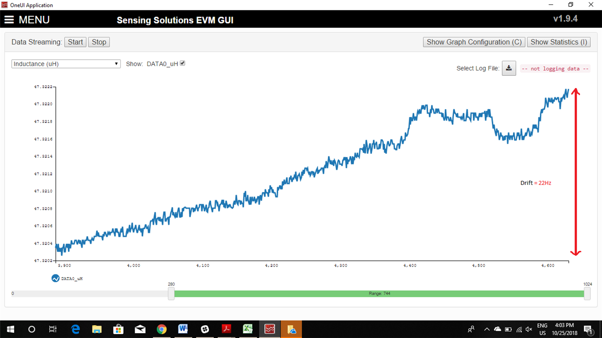

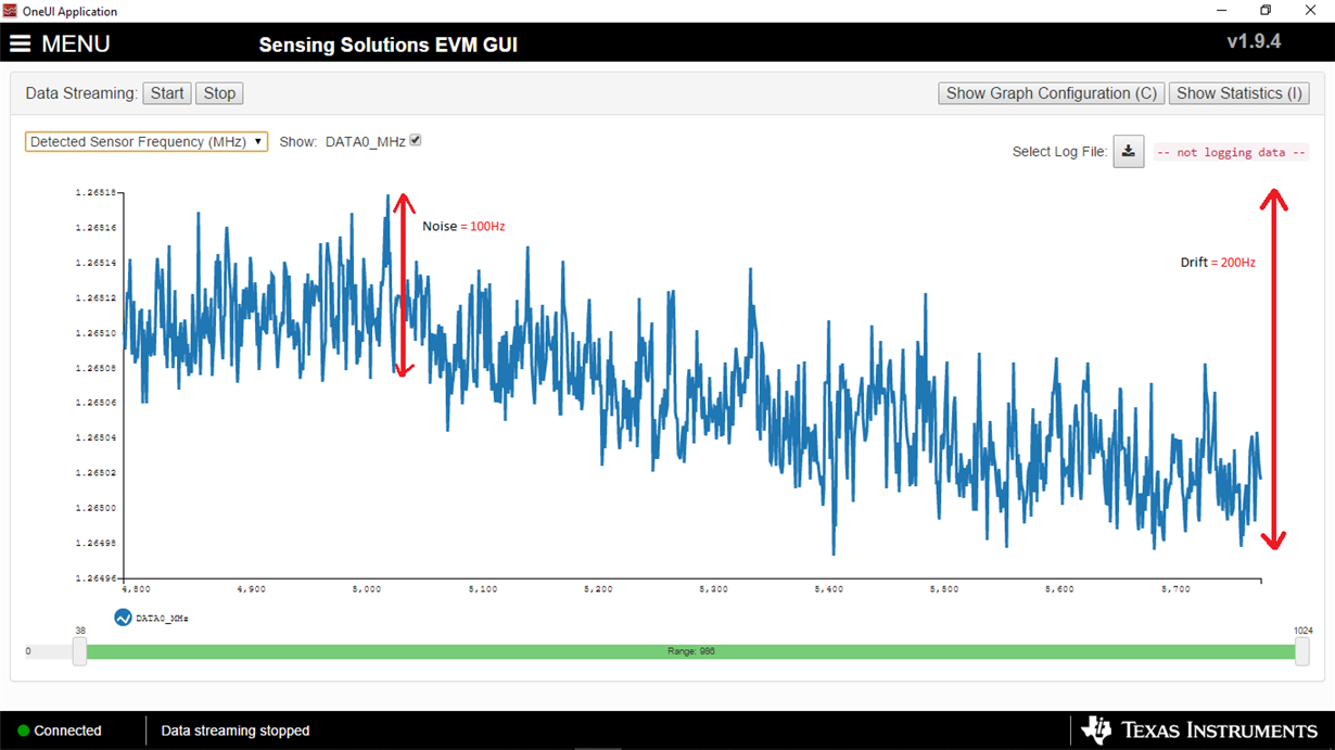

I am trying to read data from LDC1612 EVM board and I tried with internal and external oscillator configuration. In internal oscillator configuration the noise is more than drift and whereas in external oscillator configuration the drift is more than noise. We are getting drift around 20 Hz to 1 KHz and as per my knowledge I think its due to crystal as I tried heating the crystal using hot air gun, the drift was more. I will attach the screenshot below. Can we zero the drift using differential coil configuration? because I am seeing similar drift in both the channels but not exactly same. I am stuck at this point. Please suggest me a way.
I am using 50 turns, SWG 22 copper wire as sensor and 47 pf capacitor in parallel with it. Have set the current code to 9 which is 60 uA so that the voltage peak is above 1.2 Vp and below 1.8 Vp. Sensor resonance frequency is 1.3 MHz ans inductance is 308 uH.
First picture shows noise from internal oscillator configuration and second picture shows drift from external oscillator configuration.

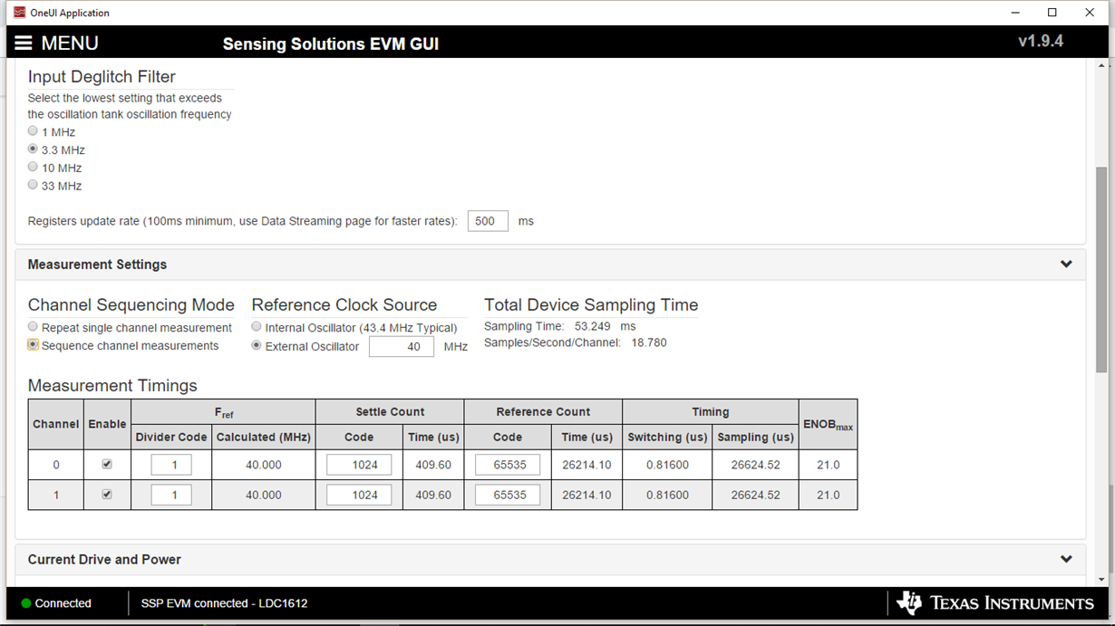

  • Hi Mahesh,
    I am familiar with the GUI. In the GUI have you tried the configuration page and set the test to multi-channel measurement? If you did this make sure you also set the correct external clock frequency. Please let me know after trying this and what issue you're facing. Please also share a screen capture of the settings used and the data measured or plotted.
    Bala Ravi
  • Yes I have set the test to multi-channel which is sequential measurement and have selected the external oscillator. But the issue I am facing is even though the coil is left free without any external influence or interface instead of getting constant reading with time, I am getting increasing or decreasing reading with time which I don't want.

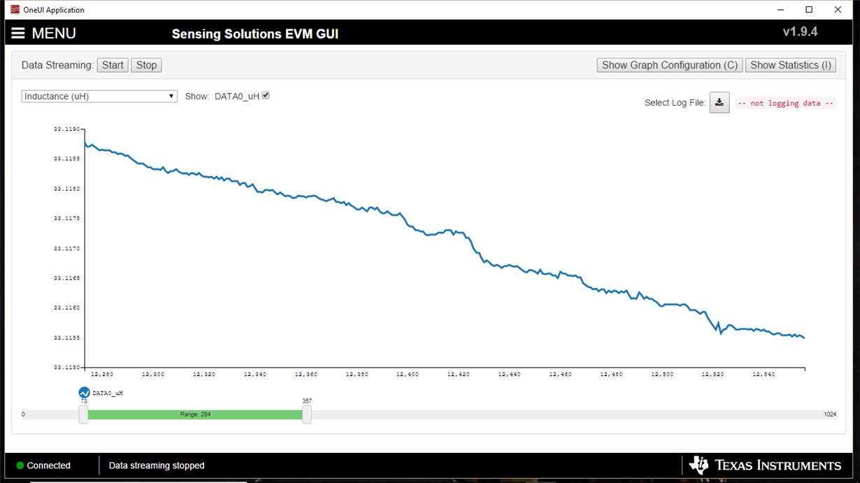

  • We are getting graph like this instead of horizontal straight line. This drift we want to resolve.
    Mahesh Shetty
  • Hi Mahesh,
                        Your setting seems right. If you look at the plot, the inductance is drifting between 33.115 uH to 33.119 uH. That's a percent change of 0.01%, which is completely acceptable.
    Bala Ravi
  • Thank you Bala Ravi.
    Yeah but that data I attached previously is taken only for a few seconds which is less than 10 seconds of data I can say and if we consider it with time then, the drift is more for minutes or hourly basis. As per my test, for 10 minutes of data the drift was almost 200 Hz in frequency and the drift is increasing with time. So I need help regarding cancellation of this drift or figuring out the reason for this drift.
