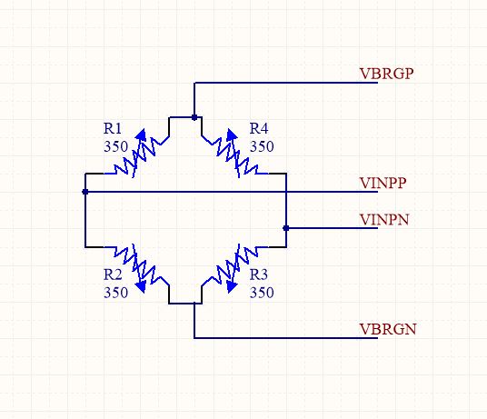

I have some questions about the bi-wire 4-20mA output regarded to some test I did recently.
My PGA900 circuit was connected to W-bridge which is connected by 4 strain gauges, each is 350 ohm.
When I set 2.5 bridge voltage, then I found the current from pin FBP is almost 9mA at DAC_REG set by 0x0000(HEX).
So, my questions are as below, plz answer each question, very thanks.
1. Is that means the bi-wire current output will have a lower limit at 9mA???
2. As I know, the PGA900 isn't designed for such low resistance of strain gauge. So If I still want to use 350 ohm strain gauge, this issue will always there, right???
3. I had tried to use 1k ohm strain gauge, but the current is 4.5mA. So I reduced bridge voltage from 2.5V to 2.0V, then the current is lower than 4mA. But to reduce bridge voltage is not good idea, because the amplify rate also need to be increased, which means the noise will increase. Do you have any solution to limit current lower than 4mA on using 350 ohm strain gauge and 2.5V bridge voltage????
My W-birdge connection as below......
  • Hi Yimin,
    This is just Ohm's Law. The only way to reduce the current given a fixed voltage is to increase the impedance of the bridge.

  • Hi Brian,
    1. Yes, that is correct.
    2. In a 4-20mA current loop output device, the only connections to the device are the power and the current return line. With only those two lines, the device's current consumption must be included in the output current. With that setup it is physically impossible not to include the device's current consumption.
    The bridge current and device's current consumption are not controlled, but do remain relatively stable during operation. Only the DAC output is used to control the total current output. The DAC Gain section of the datasheet describes the specifications for the DAC output buffer which affects this. Typically the DAC output is calibrated across temperature to improve the stability of the output current.
    The bridge sensor supply current limit is specified in the datasheet as 1.5mA for exactly the reasons you have mentioned. If it is allowed to consume more current, it pushes the output current above 4mA.
    If the customer is intent on using a 350ohm bridge, they have 2 options. They can either accept a smaller output range, or they can use an external buffer with its own power supply (it can be the same supply used for the Vpwr to the PGA900). The  buffer will take the VBRG output from the PGA900 as its input, and its output will go to the load cell.
