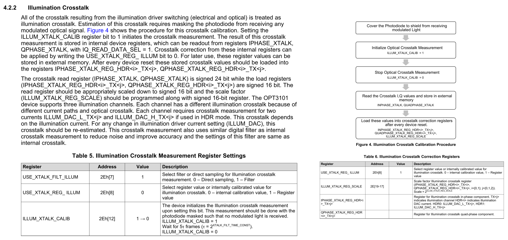

Should OPT3101 be applied the illumination crosstalk correction after power up only once ?
In addition, does OPT3101 be needed to make individual settings for each set ? Should this correction be done at the shipping test ?
