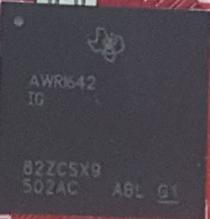

  • This may not be the problem, but just in case
    Make sure that you are using a 3A power supply.
    SDK 3.0 does not support xWR1642, you should not use it.
    Can you please take a look at the silicon on the EVM. It should be similar to attached picture (ES 2.0) silicon
    Thank you
    Cesar
  • Hello Cesar,
    please excuse my late answer. It was a busy week.
    I've checked the silicon on the board and recognized another Part number.
    The Chip on my Board lists the following Numbers:
    XAWR1642
    IG
    79ZDYH9
    502  ABL
    The "X" makes me wondering..
    What is this for?
    Greetings and thank you very much!
    Tony
  • Hi Tony,
    I checked an EVM with ES 1.0 silicon and I see the same markings.
    So, you have an EVM with ES 1.0 silicon
    You should use the SDK 1.2
    Go to this page:
    www.ti.com/.../MMWAVE-SDK
    Select "Get Software" for version 2.01.00.04
    At the bottom of the page you will see a link for "MMWAVE-SDK v01.02.00.05"
    Thank you
    Cesar
