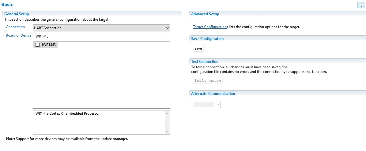

Hello!
Tell me please, is it possible to create target config for IWR1642 ICs in the CCS IDE via UART (AR_RS232TX, AR_RS232TX)?
Thank you.

  • Thanks for your reply. I am use the IWR1642 ICs on my own board where is no embedded XDS probe. And I wanted to know whether it is possible to get around without XDS when working through CCS? For example (as I understand) IDE provide this functional for IWR1443 (see attached image). At now, i can download firmware to external flash throw UniFlash by RS232 (UART). On my PCB also route JTAG from IWR.
  • Hi Rustem,
    Our Demo applications do not include the UART monitor module which would be required for UART debug to work. We recommend having a JTAG connection on your board as it which provides debug capability even if your application is not running or crashes. UART based debugging may be limited in functionality compared to XDS/JTAG debug connection.
    -Nitin
