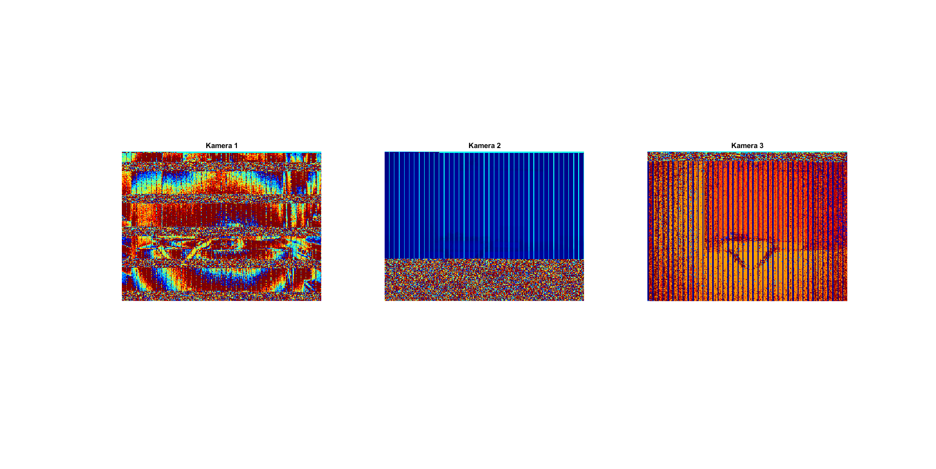

I would like to work with 3 TOF-cameras (OPT8241 Evaluation Modul). I use Voxel SDK 0.6.10. Most frames i got are damaged.

    Is the camera working fine with Voxel Viewer software?
    Subhash
    thank you for your replay. The camera work with Voxel Viewer. I have changed the source code. Now i start every camera in an own thread. This solve the problem with the damaged frames. But sometimes i get an error messege like:
    WARNING: USBBulkStramer: Resetting bulk endpoint at 1542179927492660
    ERROR: USBIO: Could not transfer  307200 bytes
    ERROR: USBIO: Could not transfer  0 bytes
    WARNING: USBBulkStramer: Resetting bulk endpoint at 154217992883281
    At this points i lost up to 20 frames.

  • Hi Malte,
    It appears that USB is unable to handle the data for three OPT8241-CDK modules simultaneously. Could you try using two cameras and confirm if they're running properly?
    Does reducing the frame rate help? Try a lower frame rate, like 10 fps or so.
