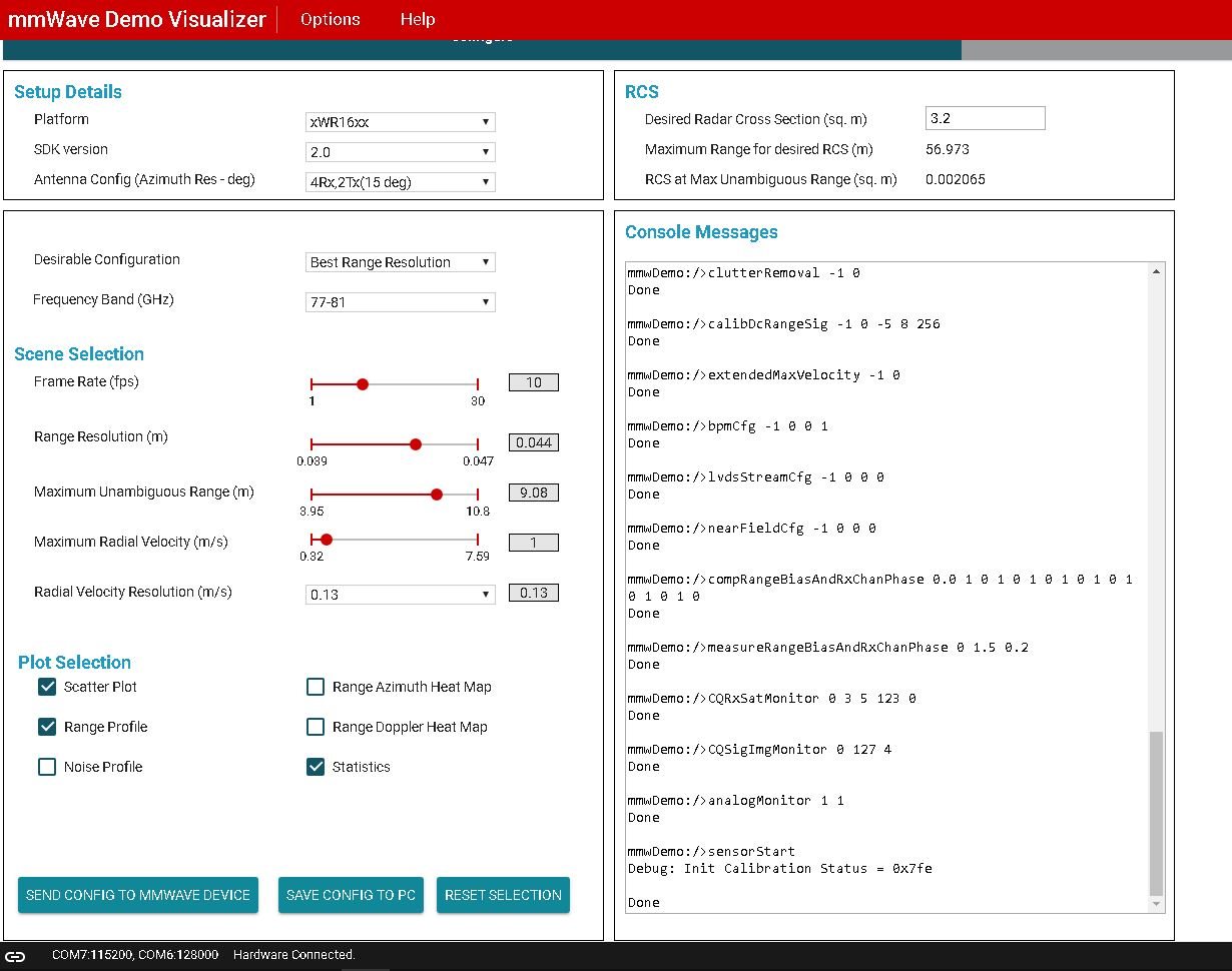

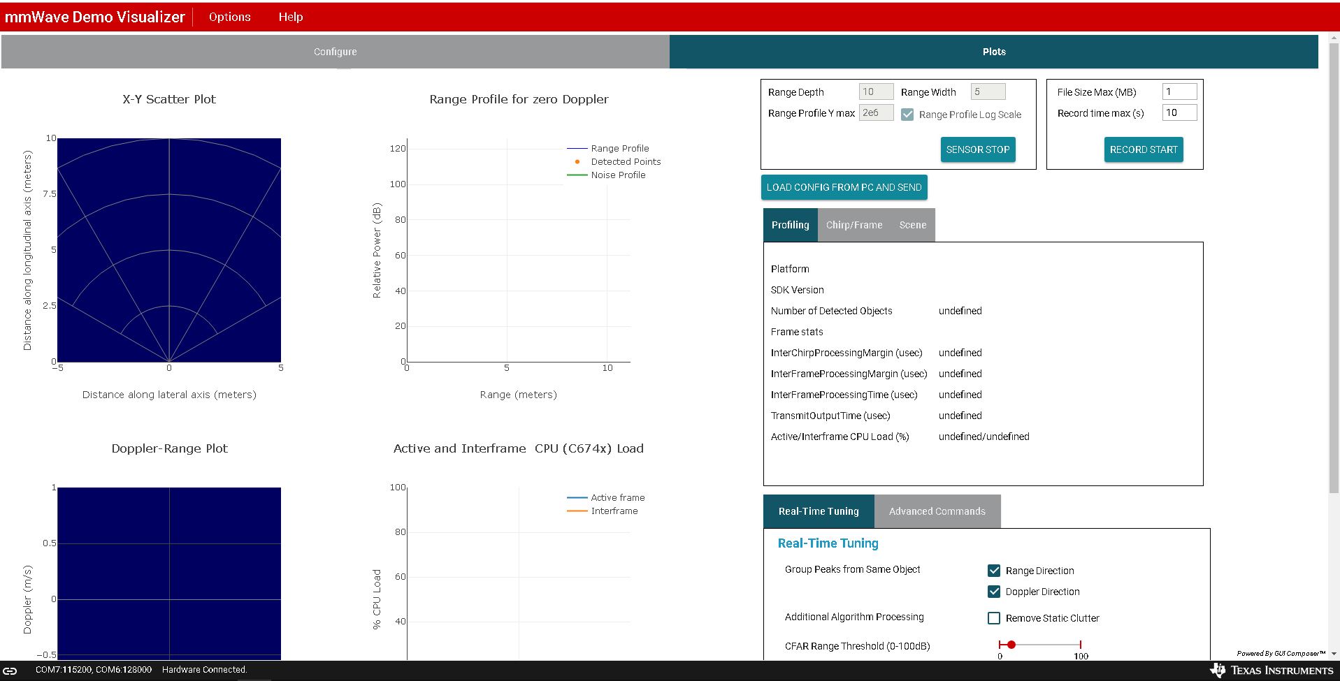

Hi everyone
I have AWR1642BOOST with SDK version of 2.0. The device is connected with no error messages but it didn't produce any change in the plots. I also realized that the items in the profiling tab are undefined. The baudrate was not set at recommended value due to computer limitation, is that the problem?. The pictures are attached below. Can anyone help me?Thanks
  • Rizki,
    You need to set the following baud rates for the two USB serial ports:
    - XDS110 Class Application/User UART Port: 115200
    - XDS110 Class Auxiliary Data Port: 921600
    Any other values besides the ones listed above are not supported. Please adjust to these correct values.
