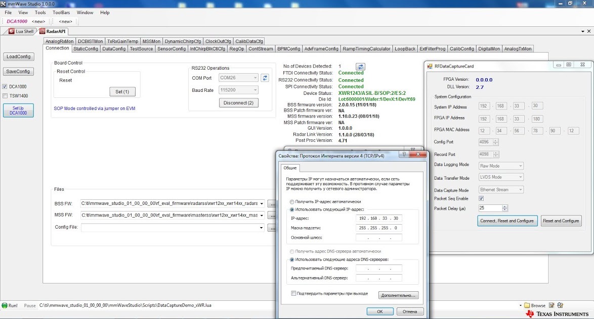

  •  I 'm trying to connect AWR1243 BOOST with DCA1000EVM to mmWAve Studio, for debugging i use Diamond programmer v 3.10 x64.
    All Things that i've done is according DCA1000's datasheet :
    1. Erase FPGA's memory.
    2. Download new programming file from mmWAVE studio directory.

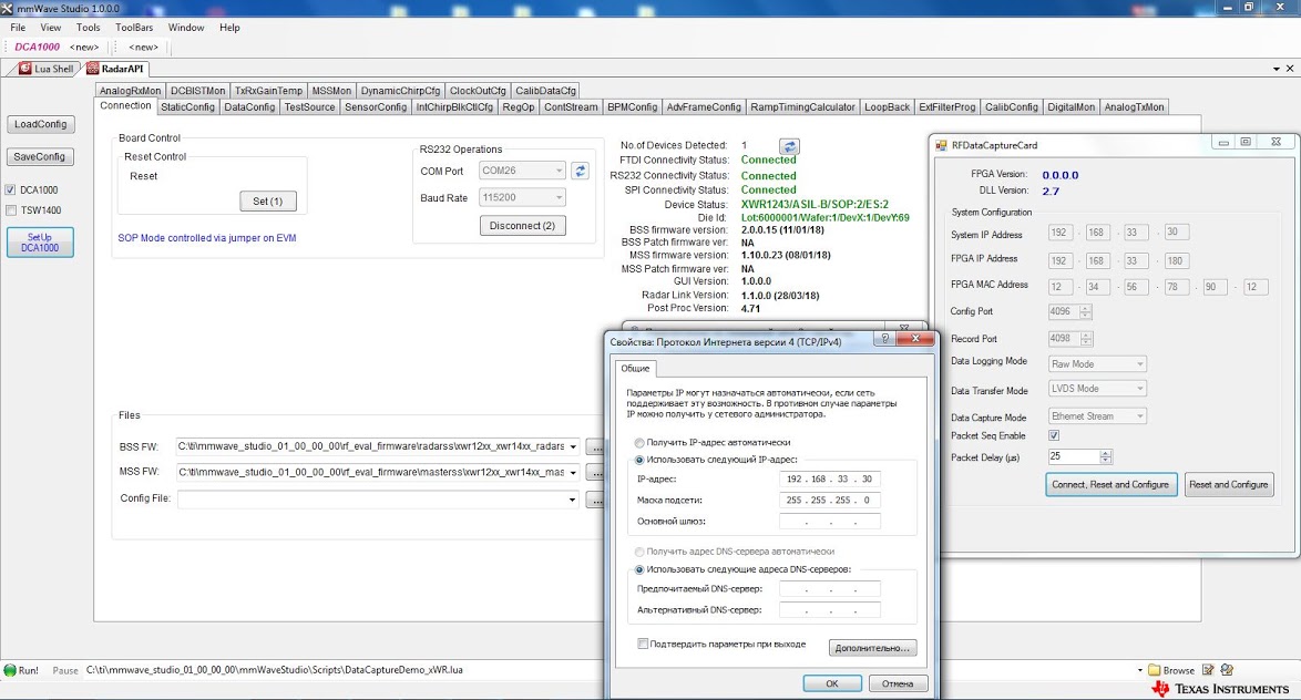

    Problem with bypass register is gone, But after "sucsessful" programming of FPGA (as it was written in Diamond programmer) I still can't connect DCA1000EVM to PC using Ethernet. (Look at window "RF data capture Card" on screenshot) Looks like something wrong with FPGA. What need i do??

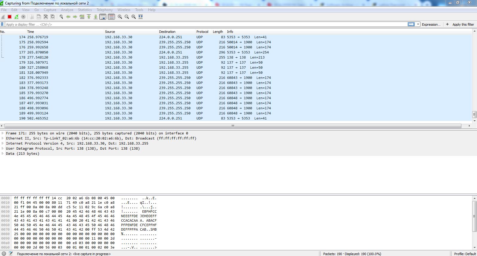

  • just have downloaded a new version of mmWave studio, downloaded to FPGA new programming file, but still  there is no connection between PC and DCA1000EVM through Ethernet. I 've seen it on WireShark, there is no reply from DCA1000. How to fix that?? (below you can see screenshot from Wire Shark)
