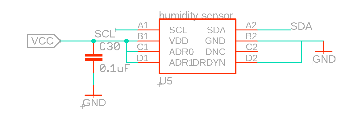

  • Hi Please find the code and schematic diagram for HDC1000 below:

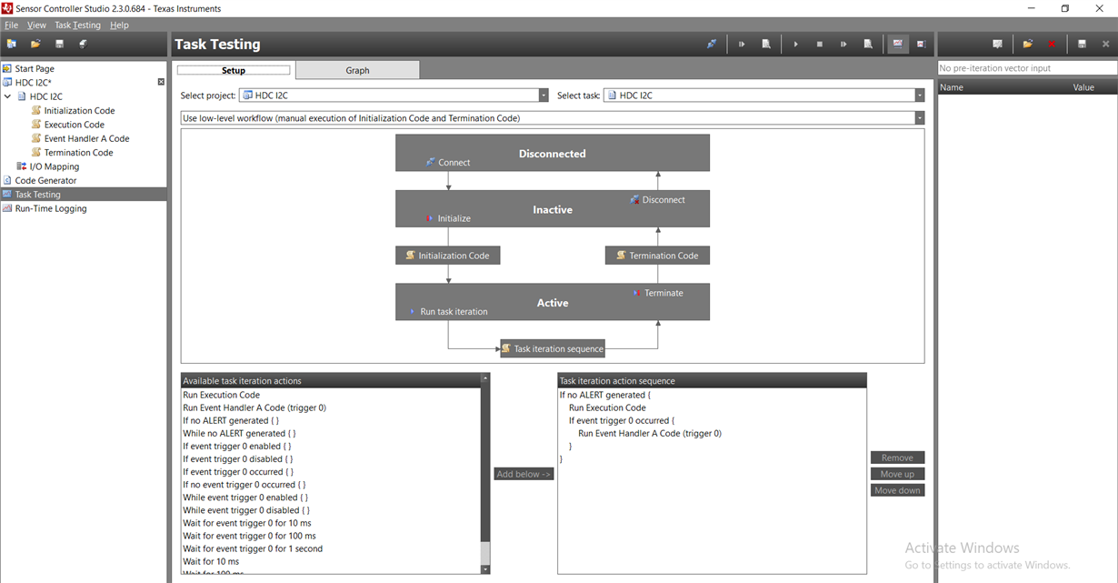

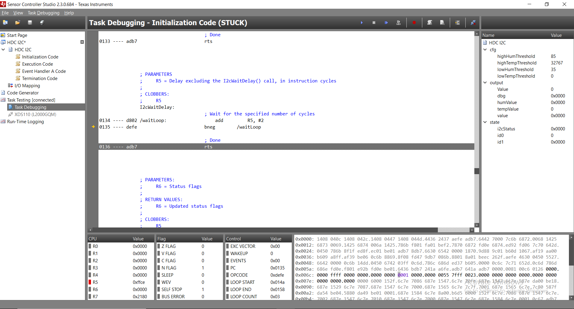

    I have tried the above given code but my execution got struck on initiation code itself, can you please have a look on it:
    Given below is the screenshot of error and HDC_cfg.:

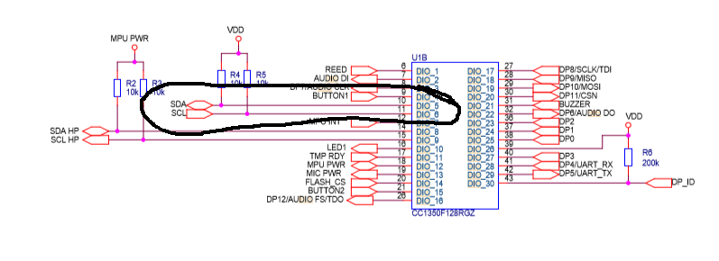

  • Are you using evaluation board or custom board?
    Can you post your I/O Mapping?
    Is the main CPU using i2c driver?
  • we are using custom board.
    I/O Mapping:
    cc1310 SDA pin <----> A2(HDC1010)
    cc1310 SCL pin <-----> A1(HDC(1010)
    Yes main cpu use i2c driver

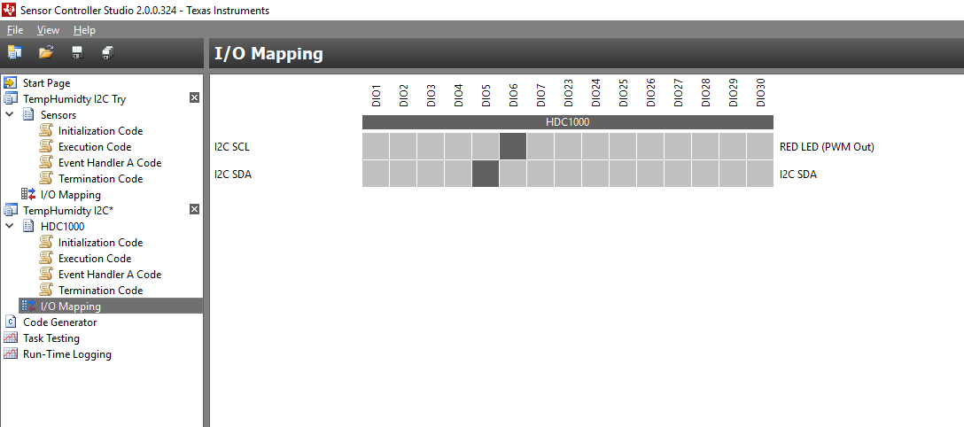

    I meant the I/O mapping in Sensor Controller Project. Above 'Code Generator' tab there is 'I/O mapping' tab where you map your IO pins (I2C in this case) to DIO pins on CC1350 cpu.. If you attach picture of SDA and SCL lines to the CC1350 cpu, I maybe can help with that. In the evaluation board:
    Then in Sensor Controller:
    Try disable all usage of I2C in application first. Don't use I2C_Open or any other I2C functions, add it after you have the sensor controller application working...
    Can you please check I/O mapping in sensor controller is:
