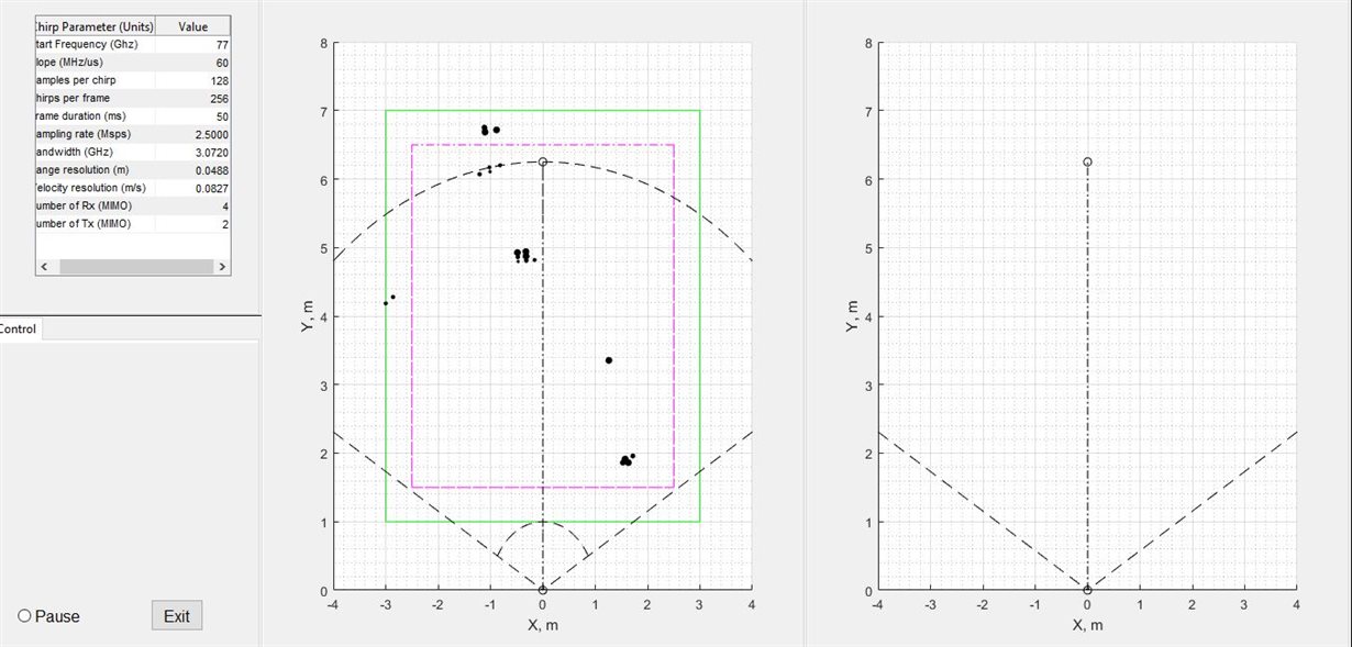

How to Avoid Indoor False Detection in PPLCount demo code for IWR1642BOOST EVM, Industrial toolbox 3.01 and SDk 3.08
I try to avoid Fan, Plants and Curtains, I try avoid this in changing Configuration files but it not working
try to provide some references and Guide me how achieve this
Rahul

    The false detection mitigation relies on additional algorithms that involve a classifier on top of the typical people counting demo. Therefore the feature can not be implemented just by changing the configuration file. If you are interested in the false detection mitigation lab a IWR6843 ISK device is required as linked in the user’s guide. The lab is not supported on the IWR1642BOOST EVM and it is recommended to acquire an IWR6843 ISK.

    I try to use Indoor false detection Demo for ignore Inanimate Object, import project as per IFD User Gide and it's work
    I need make changes for GUI Work with Code and its work but IWR1642 response is very week
    for reference i am attaching Cfg file and GUI Outputindoor_false_det_68xx - Copy.cfg
    what i need to do for improve my IWR1642 Performance
    Rahul

    The Indoor False Detection demo has been tuned and tested for use with the IWR6843 board. It is possible with modifications to compile and run on the IWR1642 but this is not supported nor are configurations for optimized performance on the IWR1642 provided. Please run the lab with the IWR6843ISK as instructed in the user's manual to understand the performance of the lab.

    I am running this same lab on a IWR6843
    However, on the ifdm_demo.exe screen, i get the following output, please advise:

    Sending configuration from indoor_false_det_68xx.cfg file to IWR16xx ...
    dfeDataOutputMode 1
    Warning: Unexpected Warning: A timeout occurred before the Terminator was reached.
    Warning: Unsuccessful read: The specified amount of data was not returned within the Timeout period..
    channelCfg 15 5 0

    This error is because the COM port cannot be connected. Please make sure that you have removed the SOP2 jumper after flashing, have power cycled the board, and have closed Uniflash or any other mmWave that can connect to EVM COM ports.
