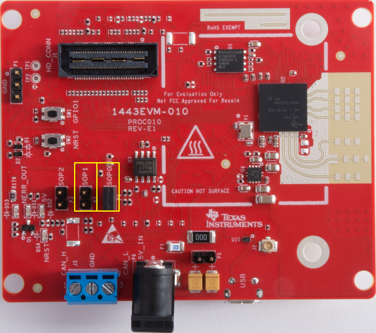

  • Cha,
    What is the SOP settings that you are using when you use the DCA board?
    Make sure that you have jumper on SOP0 and SOP1, check image below in the yellow boxes.
    Alex
  • Hi Alex
    I already did that picture.
