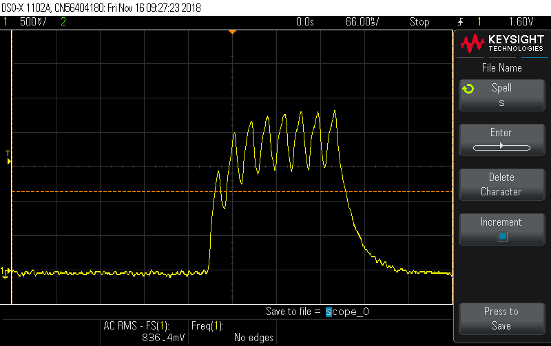

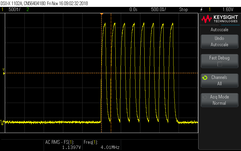

We need hardware support on the problem we see here. We spun a custom AWR1243 board based on the D3 Satellite Radar Module design and are trying to flash the firmware on the board (radarss.bin, masterss.bin and the config.bin from the Vision SDK) and encountered an issue with the SPI clock coming out of the AWR1243. Please see attached pics. The clean clock pic was taken from the D3 board and the other pic was taken from our AWR1243 custom board.
On D3 board we can see a clean clock coming out of AWR1243 at 4MHz with 3.3V magnitude. On our board we see 40MHz clock that is clean but not correct with magnitude of 2.5V. At this point we don't know why there is such a discrepancy in clock frequency and why it was distorted the way it exhibited.
On D3 board there is a 22Ohm resistor in series with 8pF max capacitor foing into Cypress flash chip SPI input clock. We tried different resistor values (1Ohm and 82Ohm) but have the same results.

    1) We are following D3 netlist and BOM. In fact we have not made any changes on parts and shematic and PCB layout.
    2) We used different stack up and dielectric for board however at this moment it does not explain why we are measuring clock 10 times faster on our board compare to D3 board. (please see attached pictures)

  • BTW first 2 pics are from D3 board and last one from Metawave board.

    Talking to our boot ROM team I think this may actually be intended operation. Depending on when the devices were sampled for the D3 board being referenced, the 4 MHz QSPI clock is expected for older AWR1243 ES2.0 samples. The 40 MHz QSPI clock is expected for current AWR1243 ES3.0 samples.
    Also, judging from the different oscilloscope shots, it appears that there is nothing wrong with this clock other than the difference in anticipated frequency. The first scope may have not had sufficient probe or input bandwidth relative to the second. Can you please confirm that the clock signal integrity looks good with the higher bandwidth scope? This would change the QSPI clock constraints of the attached QSPI flash memory as well.

    This is Khai from Metawave working with Tom on the same issue. The issue has been solved. We used ES3.0 version and the chip has been flashed with respective FW. It's up and functional.
