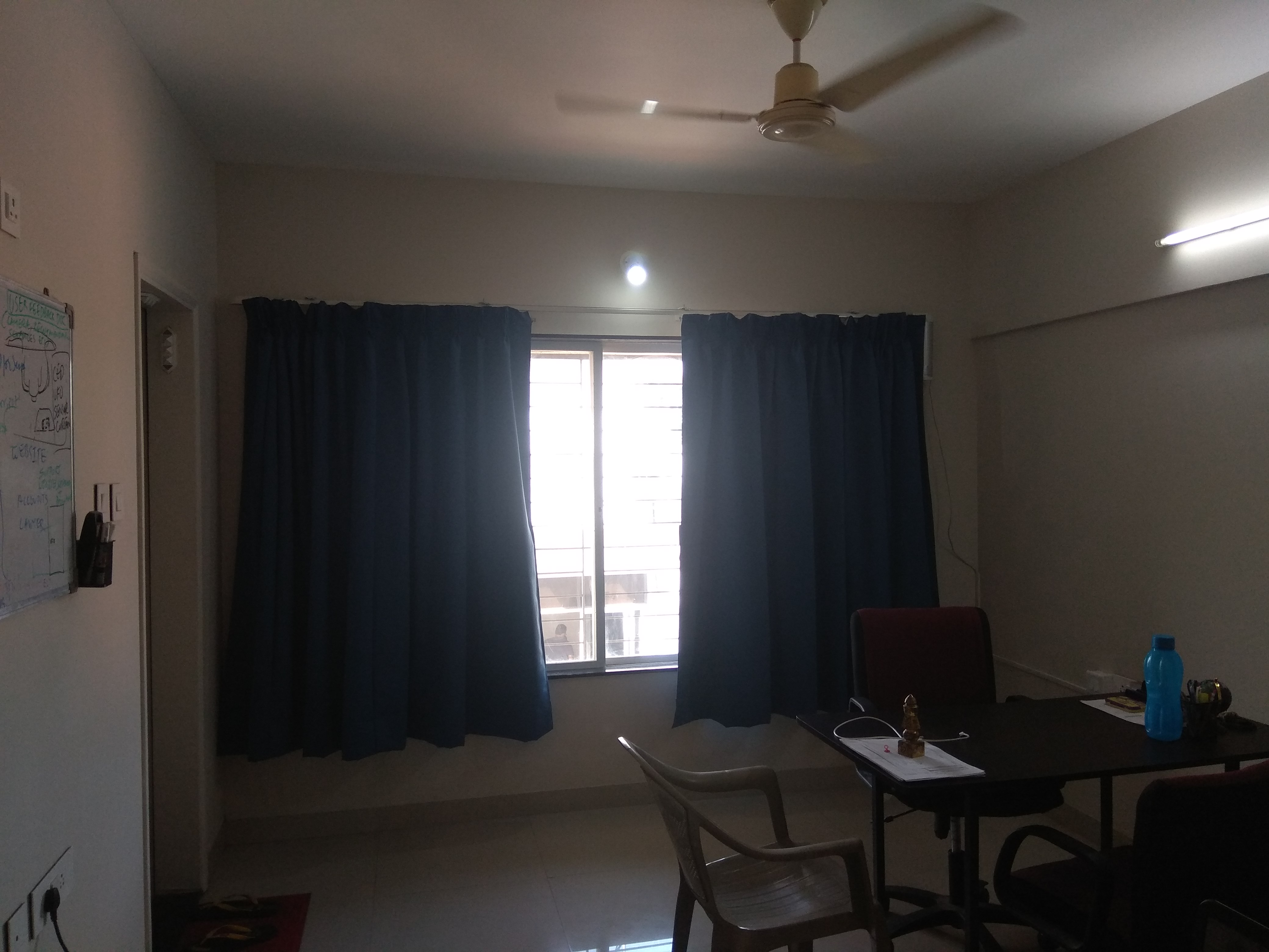

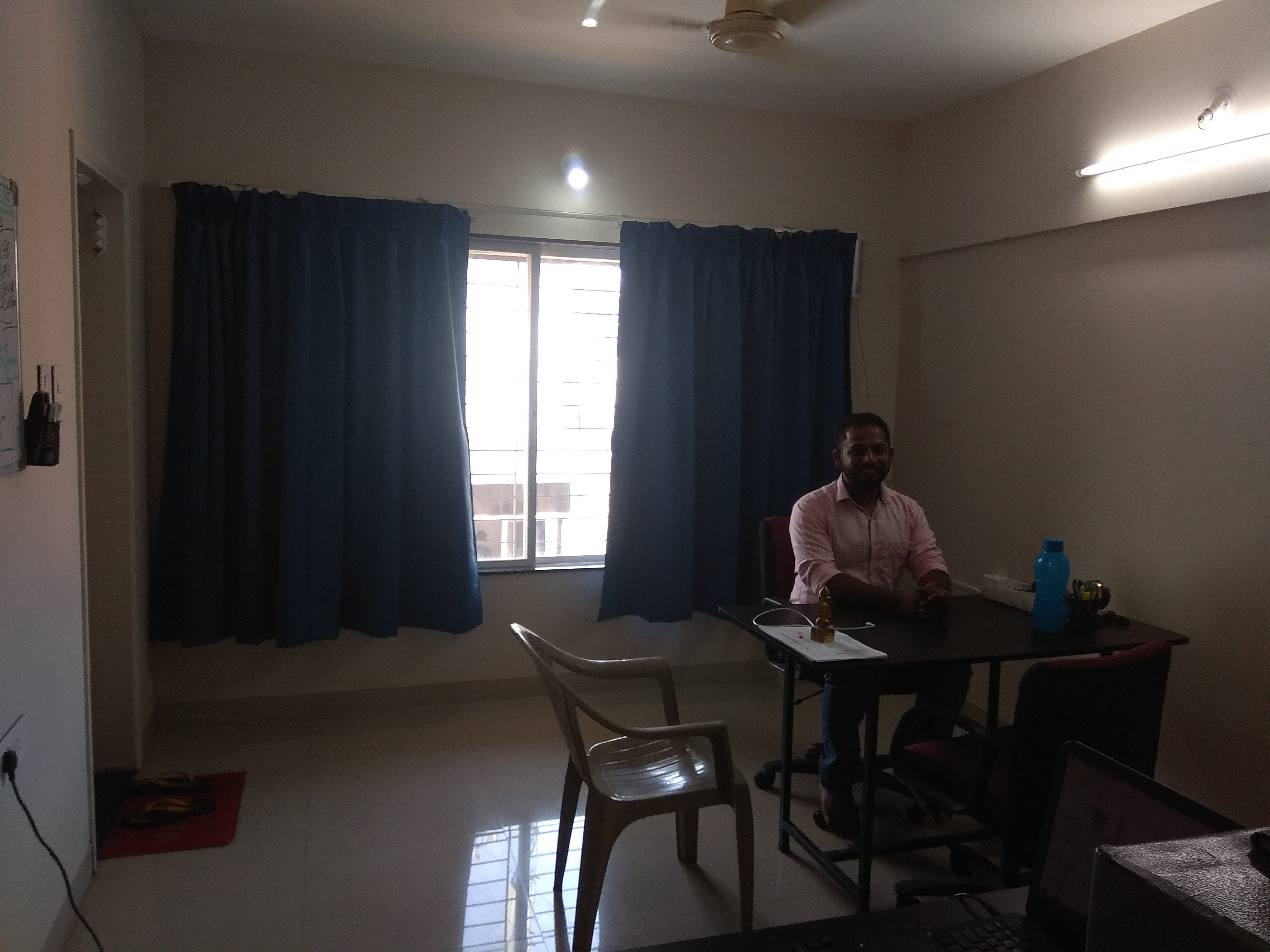

  •   Hello Vaibhav,
    the scene in front of the sensor when I noticed the unwanted detection is Curtains and Fan, i am sharing Photos of environment
    when Fan is off then it's detect accepted count but release detection after few minuets/sec(randomly)

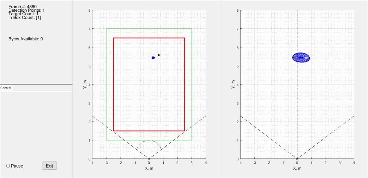

    I am want run this demo ideal condition like
    1.Man is seat in mmWave sensor detection range
    2.Room Fan ON(Run in any speed)
    3.Room Curtains are closed
    Accepted result in Ideal condition of mmwave Sensor is Detection Point 1 or Target Count 1
    as per Indoor False Detection demo need to show curtains and Fan is Inanimate Object  and detect only man who is seat on chair

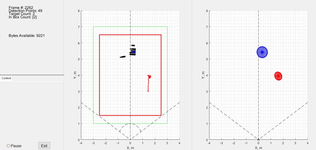

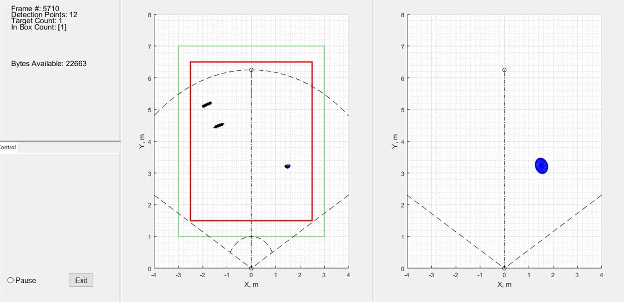

  • Hello Vaibhav,
    Result Of above mention scene of GUI
    it's resale the detection (Man present in Room On Red Color)
    Detect inanimate Object (Fan detected continuously on Blue)
    Rahul
