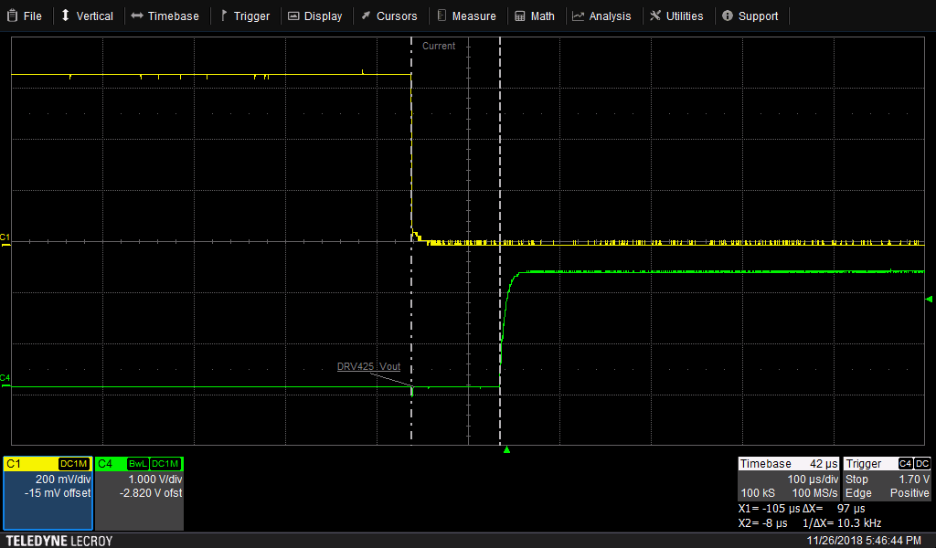

    If you have some knowleadge about follows, could you share us it?
    -When the magnetic flux density changes from 20mT(saturation area) to 2mT, how much will be recovery time and residual hysteresis?
    We assume that the recovery time is quickly as our assumption.

    I do not have the capability of testing 20mT to 2mT but I was able to test from ~4.75mT to 0mT and I have provided a screen shot below.  The yellow trace is labeled current as it is a measurement of current that is generating the magnetic field.  Vout is the DRV425 Vout referenced to GND.  I have a 5V supply and Vref is set to 2.5V.  Therefore at zero magnetic field Vout =2.5V.  You can see the response is approximately 100uS from coming out of saturation.  Also this is with Rshunt at 100 Ω and the part device saturates at a lower field and also decrease the bandwidth but I do not believe it will change the time to get out of saturation.
    Please let me know if you have further questions.
