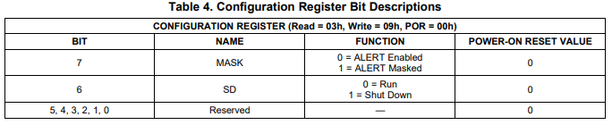

My customer has a question about TMP400.
[Q]
Please tell me how to mask Remote Sensor's Alarm(RLOW/RHIGH) when Remote Sensor is not in use.
[Expected behavior]
Do not use the Remote sensor, measure the temperature on the Local side.
Use the ALERT terminal to detect that the Local temperature exceeds the threshold.
[Current operation]
D+ and D- terminals are directly connected.
When reading the Status register (RD Addr 02h), the RLOW bit is always set and the ALERT terminal can not be cleared.
