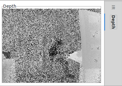

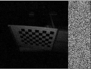

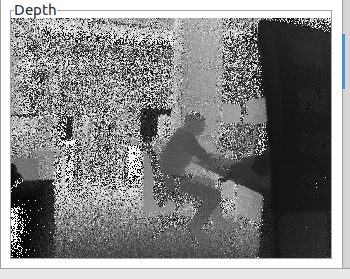

We made our-self board based on your demo-board OPT8241.
My problem is the presence big noise in phase-map for second modulation frequency in de-aliasing mode.
For first frequency it is seem OK.
It is phase-map for first frequency:  (ind_freq_data_en = true, ind_freq_data_sel = false)
It is phase-map for second frequency:   (ind_freq_data_en = true, ind_freq_data_sel = true)

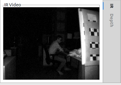

Plain IR image the same scene:

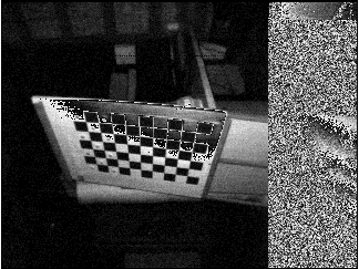

Phase-map for both frequencies:     (ind_freq_data_en = false)
