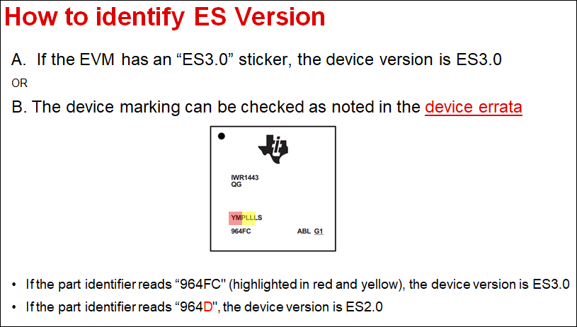

  • Hi Bartosz,
    From the description, the customer is using SDK 2.0.0.4 which does not support IWR1443. SDK 2.0.0.4 supports only IWR1642.
    Can you confirm which version of the the IWR1443 device are they using as they'll need to use the appropriate version of mmWave SDK as mentioned below.
    ES2.0 devices - mmWave SDK 1.2.0.5
    ES3.0 devices - mmWave SDK 2.1.0.4
    Adiditonally, please also check the following:
    1. Is the customer flashing ccs_debug.bin to prepare the board for CCS based debugging as mentioned in the mmWave SDK user guide - section CCS development mode? This is required to be done one time (or again after another binary was flashed) before loading the code through CCS for debugging.
    2. The correct version of CCS is used including making sure that the desktop version is used and not the Cloud version.
    -Nitin
