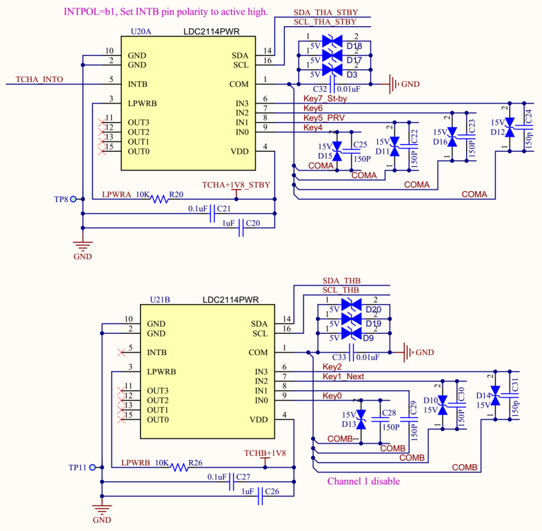

Hi Team,
We use LDC2114 in board and doing IEC61000-4-4 test(1kV noise couple in AC cable), the I2C bus will hand up easily, even crash the I2C bus which lead to other I2C slave device doesn’t communicate. That's unacceptable for us. We can accept LDC2114 hand up by itself but don’t interfere other device on I2C.  schematic shows below, do you have any method to close? thanks.
