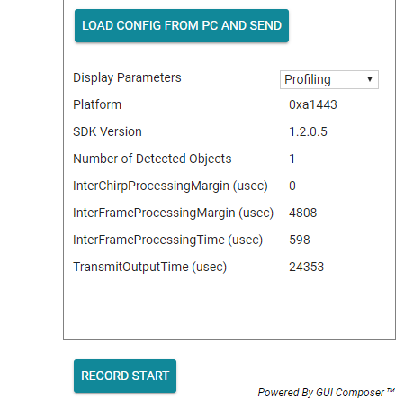

    I set frame periodicity to 10ms and the demo can't work.Then I set it to 50ms, it works well.And other parameters in 'profile_2de' are  not changed.

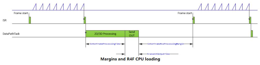

    I think this is related to processing chain time and checked some thread and realize some parameters like TransmitOutputTime really maters. So I checked Display Parameters of Profiling in High Accuracy Visualizer .It shows like this.
    According to these time information,I reset frame periodicity to 26ms and it works .26ms is the min frame periodicity I think.

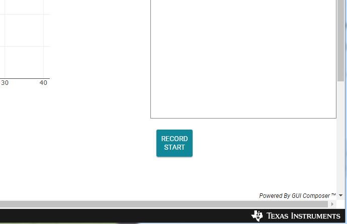

    I'm confused about your'the only data'.The data is recorded by High_Accuracy_Visualizer 1.0.1 and it's a .csv file.I pushed RECORD START button and after 30 seconds I pushed RECORD STOP button.The .csv file generated contains about 300 Frames like this.
    But according to the frame periodicity I set(26ms),there should be about 1140 frames after 30 seconds.

            I did some experiments about thisdemo.I set the frame periodicity to 50, 100, 200 milliseconds respectively(or 20Hz\10Hz\5Hz data output rate)and collected data with High_Accuracy_Visualizer 1.0.1 for  one minute.Finally I got  three .csv files and they contain about  500/600/300 data respectively.It looks like when  frame periodicity is lower than 100ms,the output data will have wrong length.
            So I collected data via COM port rather than High_Accuracy_Visualizer 1.0.1 and wrote a script to decode the data.This time I got right data length with 50ms frame periodicity.
            I think there is something wrong with High_Accuracy_Visualizer 1.0.1 and I suggest you check it out. Anyway,I solved my problems and you can close this thread.
