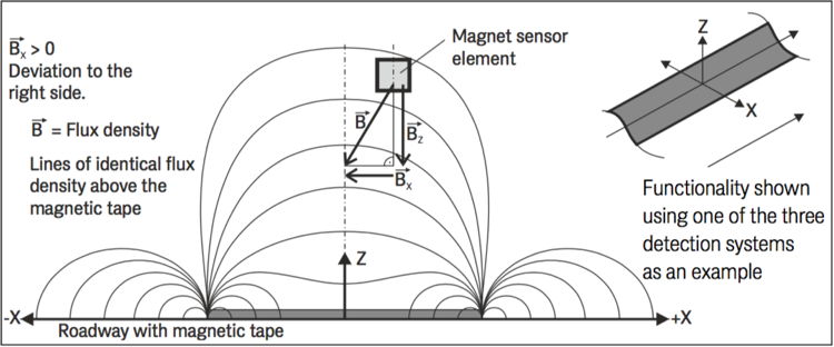

I am looking for sensors to detect the magnetic lines, as in the image.
TI has too many sensors and I have not found the right type.
With a sensitivity of 0.5 mT
The distance from the sensor to the line from 30 to 50mm
Help me find the right kind of sensor. Thank you

    If you are going to have a maximum sensitivity of 0.5 mT, then I recommend the DRV425 (a fluxgate sensor), which is a linear magnetic sensor with a full scale range of ±2mT.
    Based on your design requirements, you may be able use a linear Hall device instead. If you need a bidirectional sensor, then then you may consider using the DRV5055 (the A1 version, which has a full scale rage of ±21mT). If you only need a unidirectional sensor, then you may consider using the DRV5056 (the A1 version, which has a full scale range of 20mT). If your maximum sensitivity is 0.5mT, then you may be limited with the combined noise of the sensor and your system (which is why the DRV425 may be better for you).

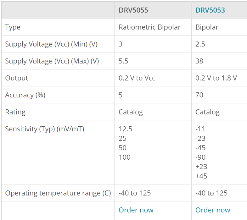

    If so, can you explain the difference between DRV5053 and DRV5055?
    I will test and share the joy with you
  • Hello Phuc,
    The table below highlights some of the main differences between the DRV5055 and the DRV5053. The biggest thing to note is that the DRV5055 is more accurate than the DRV5053, but the DRV5053 has a wider supply voltage range.  The two devices also have different sensitivity options available. There are many other differences as well (ie, power consumption, cost, etc.) which you can see in their respective datasheets and product pages.
