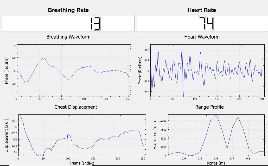

AWR1642BOOST,WHY THE DISPLACEMENT VALUE IS NEGATIVE,WHAT IS (A.U.)?
Chest displacement plot shows phase difference at every frame, so Y-Axis here shows the phase diff and x_axis frame count.
These parameters can be mapped with GUI and application source code-
gui_source\mainwindow.cpp: phaseWfm_Out with dss\dss_data_path.c: unwrapPhasePeak
