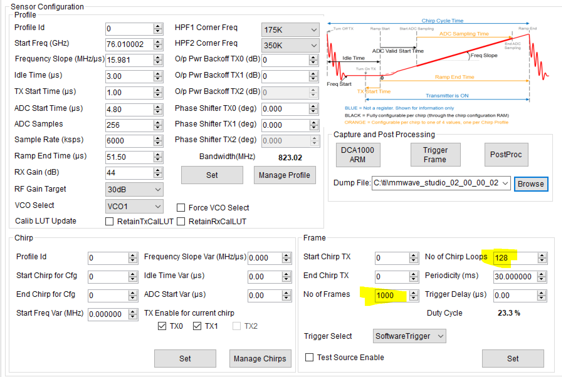

  •                                                                                                                          Fig1

    2/ see fig1 above,
    when i config 2000 frames with 128chirps/254chirp and 30ms period per frame, the total capturing time is not 2000*30ms=60s, i am confused. Why not 60s?
    And when i config 3000 frames with 128chirps/254chirp and 30ms period per frame, mmwave studio will be crashed. Why?

    Total frame duration = frame_periodicity * no_of_frame. (30mSec * 1000 = 30sec) as per above snapshot. To get 60 sec, either (60mSec * 1000) or (30mSec * 2000) in the mmWave-Studio GUI frame-config setting.
    For any kind of crashing, I would request you to use mmWave-Studio v2.0. I have tried the same version at my end for same configuration and time for a successful capture.
