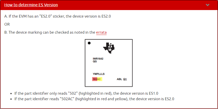

    Assuming that the customer is trying to use SDK 1.2.0.5, I understand that they have an ES1.0 Silicon based EVM. Is this correct? Note that ES2.0 Silicon boards are compatible only with SDK 2.0 and above. You can check the ES version of the IWR part as shown below:
    From the returned calibration status (0x7F2), it appears that a couple of the calibrations are failing.

    Yes, they have ES 1.0 silicon.

  • Nitin,
    Correction. It appears customer has ES2.0 silicon (devices are marked 502AC, but no sticker on the board). I will have them try with SDK 2.0 or later.

    MMWAVE-SDK: ES2.0 Silicon is compatible with MMWAVE-SDK 02_00_00_04 and above.
    mmWave Industrial toolbox: Please use the latest mmWave Industrial Toolbox i.e. version 3.1.1
    Please note that the 16xx Labs in mmWave Industrial toolbox, including the 16xx - OOB Demo Lab are compatible with SDK 2.0.0.4 only. The labs will be ported to SDK 2.1.0.4 in a future release (the date for which is not known at this time).
    This means that the customer can still download SDK 2.1.0.4 and use the corresponding OOB Demo (including building the demo using the makefile based build instructions provided in the SDK user guide), they need to use SDK 2.0.0.4 for building any of the 16xx labs from mmWave Industrial Toolbox 3.1.0.
