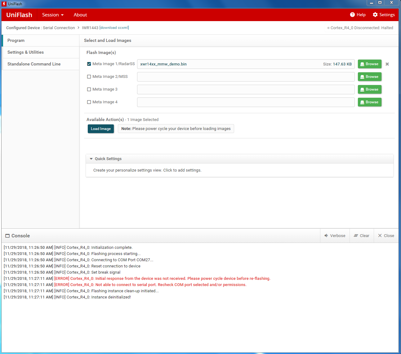

Using UniFlash 4.5.0 with the Meta Image A  field set to the xwr14xx_mmw_demo.bin from mmwave_sdk 2.01.00.04, I receive an error msg "Image Loading Failed: Not able to connect to serial port. Recheck COM port selected and/or permissions". In the console window an additional msg: "[ERROR] Cortex_R4_0: Initial response from the device was not received. Please power cycle device before re-flashing."

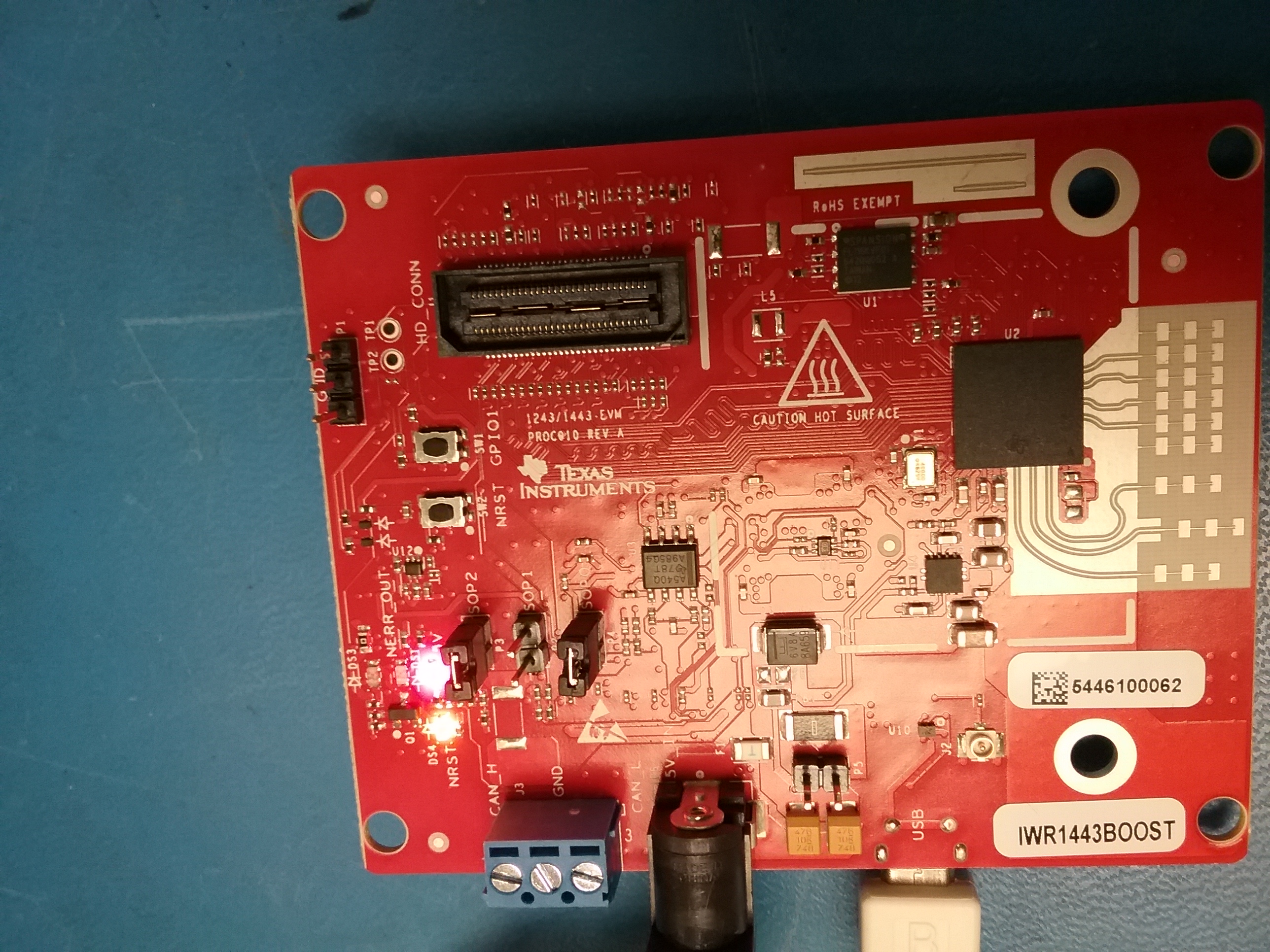

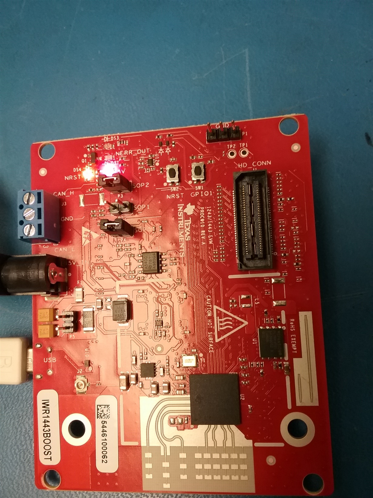

The IWR1443BOOST board has both SOP0 & SOP1 jumpers installed. The IWR1443 device has a "964FC" marking, which is an ES3.0 rev device. I have verified through the Windows Device Manager that the COMP port is set properly in UniFlash Setting & Utilities. I have tried multiple times and even on different Windows machines, receiving the same error.

    However, I'm still not able to program the IWR1443BOOST using 2.1.0.4. Again the jumpers were in SOP 0 & 2. Any suggestions?

    1. Can you send a picture of your IWR1443BOOST EVM (with jumpers set for flashing and powered up) so I can compare it to mine to make sure everything looks the same?

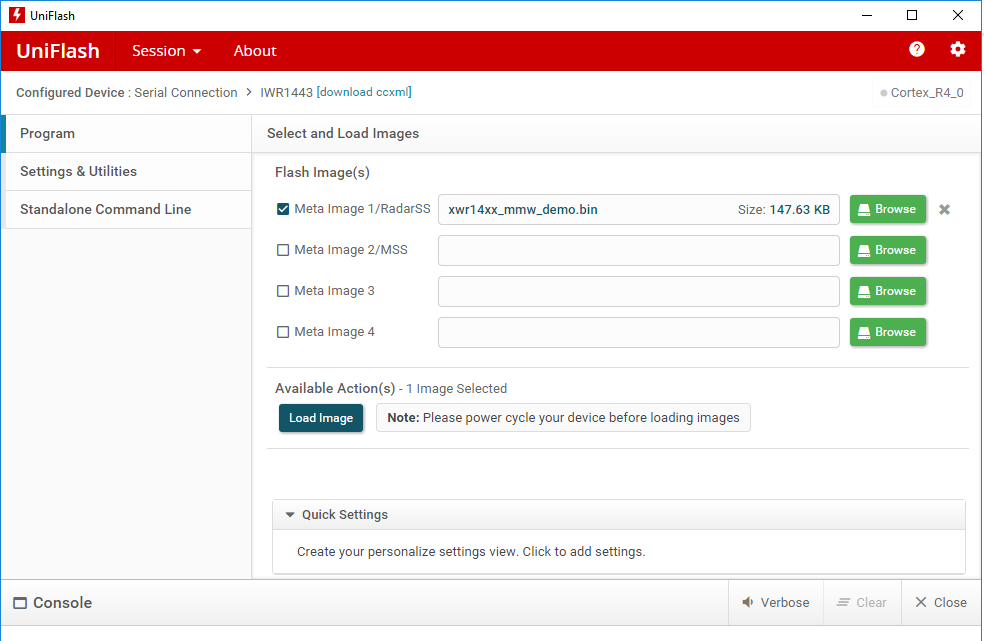

    2. When Uniflash starts does it autodetect the IWR1443BOOST board?  Can you try manually selecting "IWR1443BOOST" from the list in the lower part of the screen?
    3. Here is a picture of my Uniflash (downloaded/offline version) v4.5.0.2056 screen after selecting the IWR1443BOOST board.  Please note that the first field is called "Meta Image 1/RadarSS", not "Meta Image A" as you mentioned in the first post.  Can you confirm the name of the first field on your Uniflash?

    If you are still having problems would you mind posting a full screenshot of your uniflash? (similar to John's above, but please include the console output).

    Below are the screen shots of Uniflash after the error occurs along with the iwr1443boost again after the error occurs.

    I'd recommend confirming that you are have corrected to the right COM port in your Windows Device Manager.
