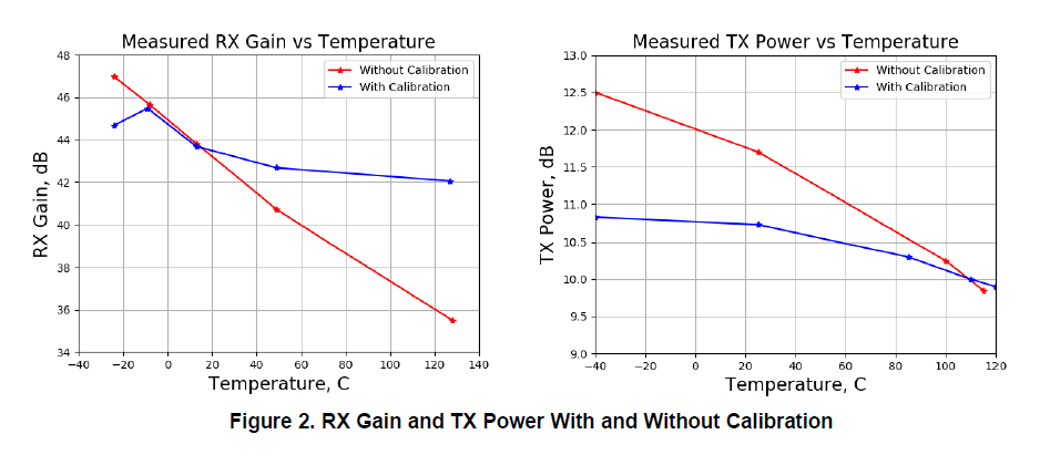

        In TI doc. spracf4 Self-Calibration in TI's mmWave Radar Device.
    What's the test setup in Figure 2? Could I duplicate the test setup?
  • Hi Cheng,
    The plots in the application note are only representative plots - they may not reflect actual device performance.
    The TX power will degrade significantly if calibration is disabled. Even with calibration enabled, it is not always possible to maintain the full TX power at very high temperatures.
    Anand

    The variation you are seeing is much higher than expected. The TX o/p power from the AWR device varies <1dB across temperature if the run time calibrations are enabled. 5-6 dB variation is not expected. Could there be some other path loss variation in the setup across temperature?
    >>By the way, we also found the case at 2 way (TX & RX), we found the S/N is almost the same at different temperature. Is it also >>reasonable? If yes, can you explain why?
    The S/N can remain same only if the TX o/p is actually similar. If that reduces then S/N would degrade. This indicates there could be some other issue in the TX o/p measurement setup.
    Vivek
