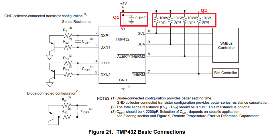

I have a question about value of bypass capacitor and pull-up resistor.
<Q1>
bypass capacitor: 0.1uF?
Is 0.1mF error in writing?
<Q2>
pull up resistor: 10k-ohm?
Is 10kW error in writing?

Hello Kaede,
You are correct in both cases, thank you for pointing this out. The Bypass capacitor should be 0.1uF and the resistors should be 10k-Ohm

Hello Brandon-san,
Thank you for your fast reply.
I understood.
I expect to fix D/S.
