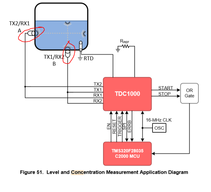

I am looking to measure the concentration of Calcium chloride solution, in the range of 30-50%. Can anyone please recommend any suitable sensors for this purpose?

I have found this design from TI, but I am not very clear what this A and B represent? I am assuming they are ultra-sonic sensors-if yes, then which model? Here is the link to this document:
I initially started the search with this sensor:
Thanks Bharat,
Please correct me if I am wrong, but I am assuming that if the solution whose concentration I need to measure is constantly moving/being agitated, this will affect the sensor?
