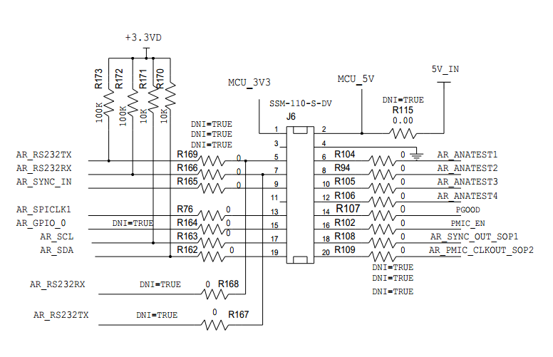

    You could consider using the device with an external hardware trigger. The device will accept a hardware trigger pulse on the SYNC_IN pin. You may need to populate resistor R165 on the AWR1642BOOST board to be able to provide this signal from the J6 connector.
    If you're using mmWaveStudio, then on the frame config section on the SensorConfig tab you will need to select Hardware Trigger instead of Software trigger, and then the Start Frame button as usual. The device will wait for a pulse on the SYNC_IN pin before starting framing. You will need to provide one trigger pulse for each frame.
    The delay between the trigger pulse and the start of the frame is also programmable.

    Thanks for the reply. What exactly do you mean by "populate resistor R165"?
    How would I do that?
    Kind Regards
    The following screenshot from the schematic shows the j6 connector and the signals going from it. R165 is a resistor in the path of the AR_SYNC_IN signal between the AWR1243 and the J6 connector. R165 is marked DNI, which means it is just a placeholder and is not installed by default on the PCB. If you wish to make use of the J6 connector to provide the trigger pulse to the AWR1243, then you will need to solder a 0 ohm resistor on the PCB where R165 should be.

    thanks for the clarification, but unfortunately I can't see any screenshot... Is this a problem on my side(?)
    Looks like the screenshot did not get added to the post.
    Please find it attached.
    Anand

    We soldered a 100 Ohm resistor into R165.
    Unfortunately, this did not work, the DCA1000 gets a (timeout)
    error after 30sec and does not react to the trigger signal.

    Also the LEDs 1 (DATA_TRANS_PROG_LED1) and 7 (LVDS_PATH_ERR_LED3) on the DCA1000 board turn on.
    We chose 100 instead of 0 Ohm for safety reasons as AR_SYNC_IN seems to be also connected to the J1 HD Connector via 0 Ohm Resistor (R62)...
    The 3.3V trigger signal gets "pulled down" to ~700mV, although we have configured HW-trigger in mmwave studio.
    Therefore we replaced the Resistor R62 on the AWR1642 by a 510 Ohm Resistor.
    This now works.
    Just for curiosity, is this really the intended way to get HW triggered frame recording?
    Furthermore, these modifications were done in a rev. A eval board AWR1642 (the R165 was not populated).
    But in our rev. B eval board R165 is populated...
    Kind Regards.
    I missed the R62 connection - the J1 connector wasn't used in our previous capture solution with the MMWAVE-DEVPACK board instead of the DCA1000.
    The DCA1000 should not have been driving this signal but does seem to be doing so in the present design.
    So the recommended modifications should have been remove R62 and install R165.
    I will check about R165 being populated already on the RevB boards - I wasn't expecting this change.
