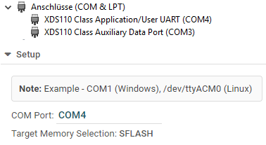

I'm trying to update the firmeware from 1.0 to the latest version 3.0. I put SOP 0 and SOP 2 to 1 and downloaded the
"xwr12xx_xwr14xx_radarss_rprc.bin" file from the website.
With UniFlash i selected the correct UART-Port (COM4) and started flashing.
Unfortunatly I got the error message below
My ports in the device manager and the setup in UniFlash
Can anybody help me

  • Hi Kevin,
    A few things might be going on here, first I'd check to make sure nothing else on your machine is connected to the UART port.
    Secondly, I'd recommend trying with a different USB cable.
    Let me know if this doesn't work and we can look into this issue further.
    Cheers,
    Akash
  • I tried to flash the mmwave_sdk_01_02_00_05 with a new USB-cable and it worked. Afterwards I powered off the board and removed
    jumpers from "SOP2" pin and leaved the jumper on "SOP0" pin. Sadly now the NERR_OUT-LED turns on when the device is in use.
