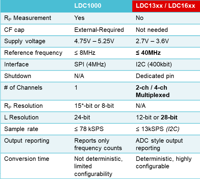

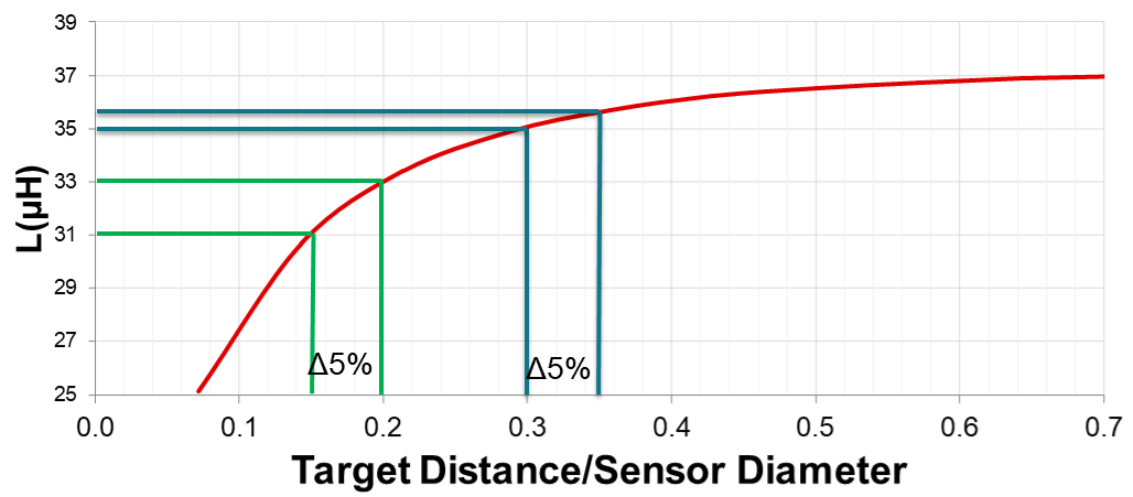

  • Hi AJ,
                Sorry about the delayed response. Yes, as long as there is a reasonable inductance change with paper as a target, either LDC1612 or LDC1312 could be used for your customer's application. There is no fixed farthest distance, it depends on the inductor size. For example, an inductor with 2x size measures 2x distance. Also closer target position is better, because it leads to a larger shift in inductance. Please refer to the plot below:
    Please find below for a brief comparison between the devices:
    As long as the old design was based on L measurement (not Rp measurement), it can be changed to a new design with LDC1312 or LDC1612.
