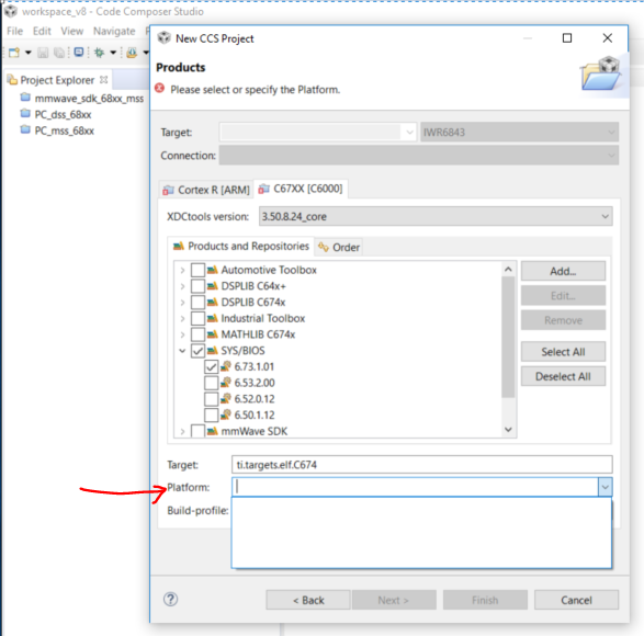

1. I'm trying to create a project for DSP Core, in this process CCS8 is not detecting the IWR6843 platform.
My system configuration is as follows.
  1. Windows 10
  2. CCS 8.2.0.000007
  3. Target Platfrom IWR6843 + MMWAVEICBOOST Carrier Card

    I am still investigating the first issue.

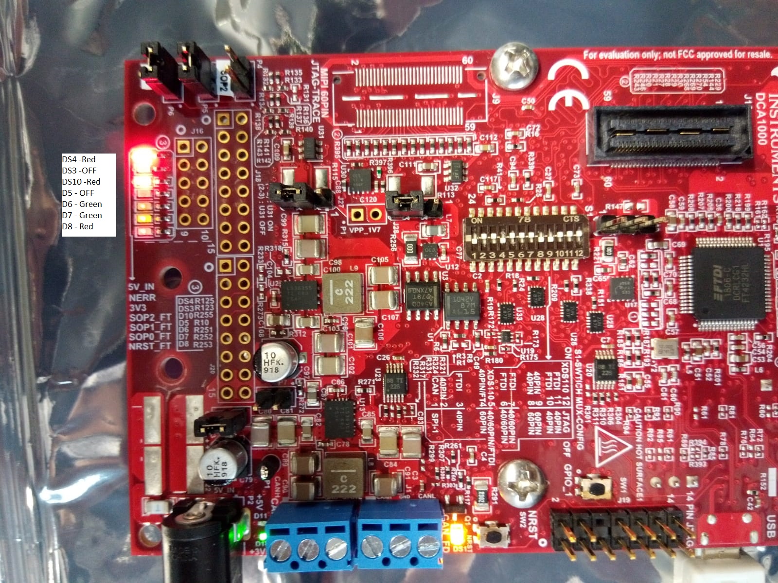

  • Hello Justin,
    Thank you for the reply.
    Jumber SOP2 is open on the EVM and I'm referencing the  swru546 document section 3.2.6.1 for this configuration. But one thing I noticed that the LED D8 is always glowing Red. Please see the LED indication in the below pic.
    Madhu K
  • Hi Madhu,
    From the picture above, there is a jumper on SOP0 and SOP1. For running demos or debugging with CCS, there should be a jumper on SOP0, and NO jumper on SOP1 or SOP2. So for SOP0 SOP1 SOP2 = 1 0 0. For flashing the device 1 0 1, for raw data capture with DCA1000 1 1 0.
    So for your use case, after flashing the device, ensure there is only one jumper on SOP0, and no jumpers on the other SOP pins.

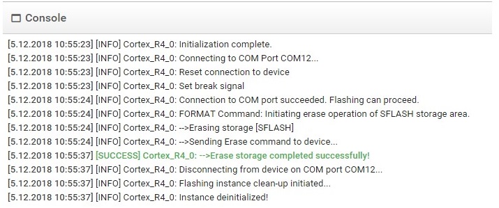

    1. Yes, as you suggested I have tried that but still the same error is persisting. Moreover now DS3 LED also glowing RED. Also request you to clarify the jumper settings in the document swru546 Section 3.2.6.1. From this jumper settings, flash mode is clear and working fine. As per my understanding Development mode means Debugging and Functional mode means running a demo. Also differing with your description. Please correct me if I'm wrong.
    2. Please have a look on the Uniflash console after flashing the binary. It is also observed that a different console print from the IWR1642 flashing.

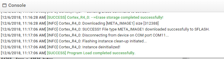

  • Hi Madhu,
    You Uniflash output should show "[Success] Program Load completed successfully", as shown below:
    Follow this process to flash:
    1. Select the IWR6843 device.
    2. Set the COM Port to the value for UART Com Port.
    3. Select the IWR6843 debug binary from SDK 3 -> <SDK_Install_Dir>\packages\ti\utils\ccsdebug\xwr68xx_ccsdebug.bin

  • Hello Justin,
    Thanks for your reply. As I mentioned in the initial post, I"m using the MMWAVEICBOOST Carrier Card with IWR6843 Antenna card. Are you using the same  setup?
    If that is the case, my hardware should be the problem. Please look at my Uniflash console, it is not printing the "Binary downloading[META IMAGE]" message. Please confirm.
    Madhu K
  • Hi Madhu,
    It appears that the issue is with the Uniflash procedure.  You are erasing the previous image, but not actually loading a new image. Please confirm that you are selecting the User UART port as shown below:
    I would select COM11 to flash the device.  Please see the People Counting User's guide and ensure the switches on the device are in the correct position.

  • Hi Madhu,
    Please import the project from TIREX.  If you have not downloaded TIREX, you can find it here.
    regards,
