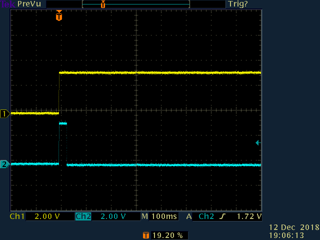

  • Hello Amit,
    I got TMP451EVM and tested it.
    Then I confirmed the same issue. When reading the status register, I found RLOW=1.
    All other registers are default value.
    Could you please also test with TMP451EVM and please explain why RLOW=1?
    Also could you tell me how to solve this issue?
    The blow is waveform at power up. CH1(Yellow) = VDD, CH2(Blue)=ALERT/THERM2
    Oba

  • Hello Oba,
    I have reproduced the issue on the TMP451EVM. After debugging it with the team, that is expected. The reason is as follows
    When the D+ and D- are connected together, the device reads the code for -64 °C (which in standard mode is 0x000) and then compares the value with the remote limit register which is 0x000 as well. This results in a comparison flag for RTLOW being set. Now w.r.t the behavior, at power on, the device starts a conversion and the results for the conversion are available after ~34ms. Hence with RTLOW being set, the ALERT pin becomes 0 after 34 ms of power on.
    The Alert function is enabled by default and hence cannot be masked out unless
    1. The MCU programs the same before the 34 ms conversion time
    2. The actual remote diode/transistor is used instead of shorting it if unused.
    I would like to hear your thoughts as well. At this point if they are not using the remote sensor, then we need to move the customer to a non-remote sensing device. Please advise.

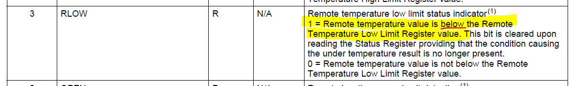

  • Hello Amit,
    Thanks for your reply. The datasheet says RLOW is set when the value is BELOW the limit value like the below figure.
    But actually it is set when the value is less than or equal to the limit ?
    And sorry, I can't understand the below your suggestion. What does it mean?
    Oba
  • Hello Oba,
    Yes, I checked with the team. The condition is less than or equal to.
